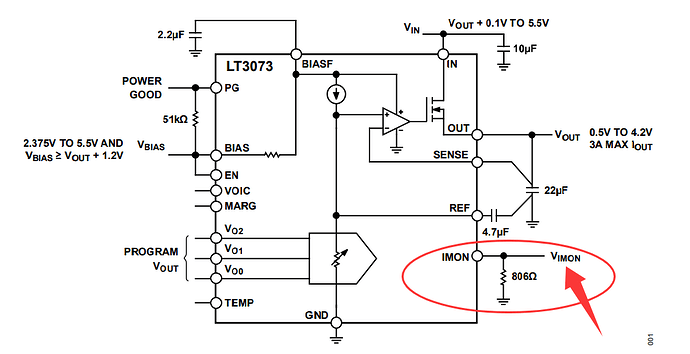

The LT3073 achieves high-precision output current monitoring through a combined solution of a dedicated current monitoring pin (IMON), fixed-ratio current sampling, and external resistor conversion.
Current Monitoring Principle: Fixed-Ratio Current Sampling
The core logic of current monitoring in the LT3073 is to scale down the LDO’s output current (IOUT) at a fixed ratio (1:3000) and output the monitoring current ( IIMON ) through the IMON pin. The relationship is expressed as: IIMON = IOUT / 3000
This proportional relationship remains stable over the full load range (10mA to 3A), and its accuracy is guaranteed by an internal calibration circuit, with a typical error of only ±3% (at 3A) — meeting the system’s high precision requirements for current monitoring.
Internal Integrated Precision Current Monitoring Circuit of LT3073 (Image source: ADI)
Hardware Implementation: Current-to-Voltage Conversion
The IMON pin outputs a current signal, which needs to be converted into a voltage signal detectable by the system using an external resistor (R₍MON₎). The following two points should be noted in the specific design:
1. Resistor Selection and Connection
It is recommended to use high-precision resistors (1% tolerance or higher). One end of the resistor is connected to the IMON pin, and the other end is connected to the LDO’s GND pin via Kelvin connection (to avoid errors caused by PCB trace resistance).
Example: To monitor a full-load current of 3A, select R₍MON₎ = 0.8kΩ. The monitoring voltage (V₍IMON₎) is calculated as:V₍IMON₎ = 1mA × 0.8kΩ = 0.8V. This voltage can be directly connected to an MCU/ADC for sampling.
2. Load Current Range Adaptation
If the load current is lower than 3A, the monitoring voltage will decrease linearly in proportion. For example:
- When the load current IOUT = 1A: IIMON = 1A / 3000 ≈ 333.3μA, corresponding to V₍IMON₎ ≈ 333.3μA × 0.8kΩ ≈ 0.267V;
- When the load current IOUT = 500mA: IIMON ≈ 166.7μA, corresponding to V₍IMON₎ ≈ 0.133V.
This linear characteristic ensures monitoring precision over the full load range.
