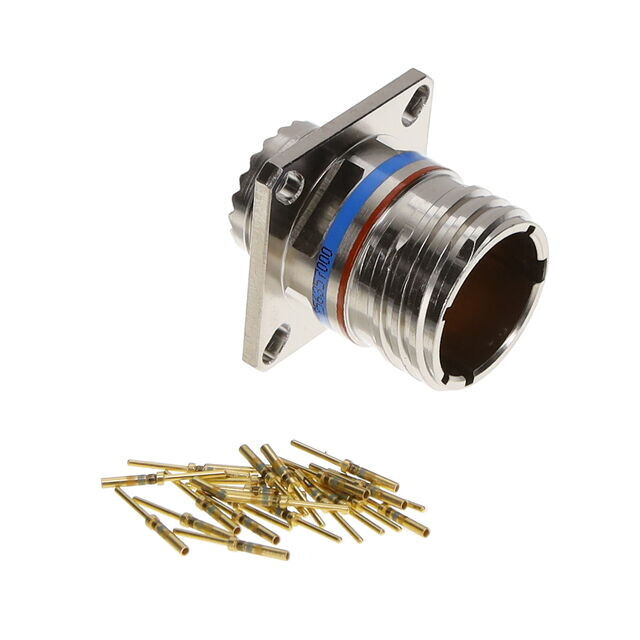

Amphenol Aerospace is a well-known supplier of military-style components for rugged applications. Unfortunately, finding tooling for these products can sometimes be quite the trick. Is there a specific removal/extraction tool for this connector?
In this case, you can use M81969/1-04 as both an extraction or removal tool and an insertion tool for this connector, as well as most any other connector in its series that uses size 22D contacts.
