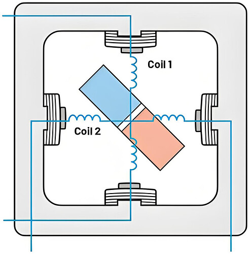

To better understand the stepping behavior of stepper motors, we evaluate a simplified 2-phase stepper motor model with one pair of magnetic poles.
Simplified 2-Phase Stepper Motor with Permanent Magnet Rotor (source: ADI)
