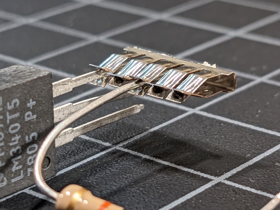

In this engineering brief we will explore the internal workings of a solderless breadboard and then present a helpful tip for the use of larger components such as TO-220 packaged MOSFETs, transistors, and voltage regulators. Our conversation is focused on the breadboard finger springs and the flat blade of the TO-220 device as pictured in Figure 1.
Figure 1: The solderless breadboard spring finger is overstretched by the flat blade of a TO-220 device.

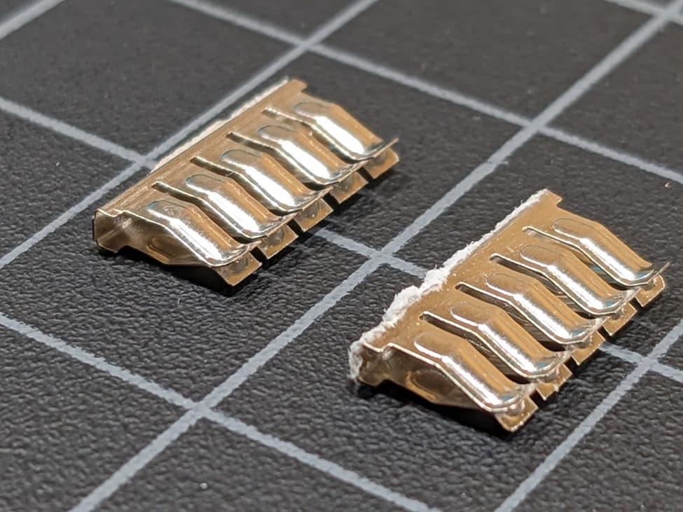

Today, the term breadboard refers to devices such as the one pictured in Figure 2. The breadboard is “solderless” as it allows quick temporary electrical connection without the need to solder. It is also convenient as the components simply push into the board. Hand tools such as screwdriver and pliers are not generally required.
Figure 2 presents the wide range of devices that may be connected using the breadboard including through-hole components and Surface Mount devices (SMD) with the assistance of an adapter board.
Figure 2: An under construction solderless breadboard circuit featuring a surface mount adapter for the microcontroller, an LCD, and a switching voltage regulator.

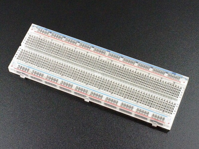

A solderless breadboard consists of a series of spring fingers, as shown in Figure 3. A full-sized breadboard will have over 120 of these 5-position fingers are arranged the row / column matrix shown in Figure 2. For example, pin zero of the microcontroller is connected to the spring finger located at position 35.
Note that longer spring finger assemblies run the length of the breadboard (horizontal in Figure 2). Collectively, these are known as “rails” and are used to distribute power and ground to the circuit.
Figure 3: Spring fingers provide a convenient connection for small through-hole electrical components.

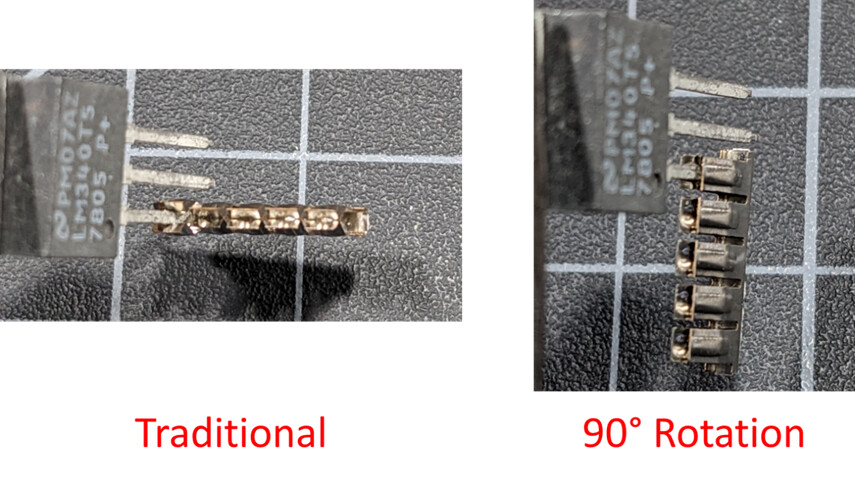

Figure 1 shows the pin of a resistor and the pin of TO-220-packaged device held by the 5-position spring terminal. By comparison, the springs are more distorted by the TO-220 regulator. This distortion may be easier to see in Figure 4 which presents the blade as typically inserted into the breadboard (left) and then again when the blade is rotated 90 degrees (right).
Figure 4: Flat blade of a TO-220 device showing spring distortion (left) with reduced stress with a 90-degree rotation (right).

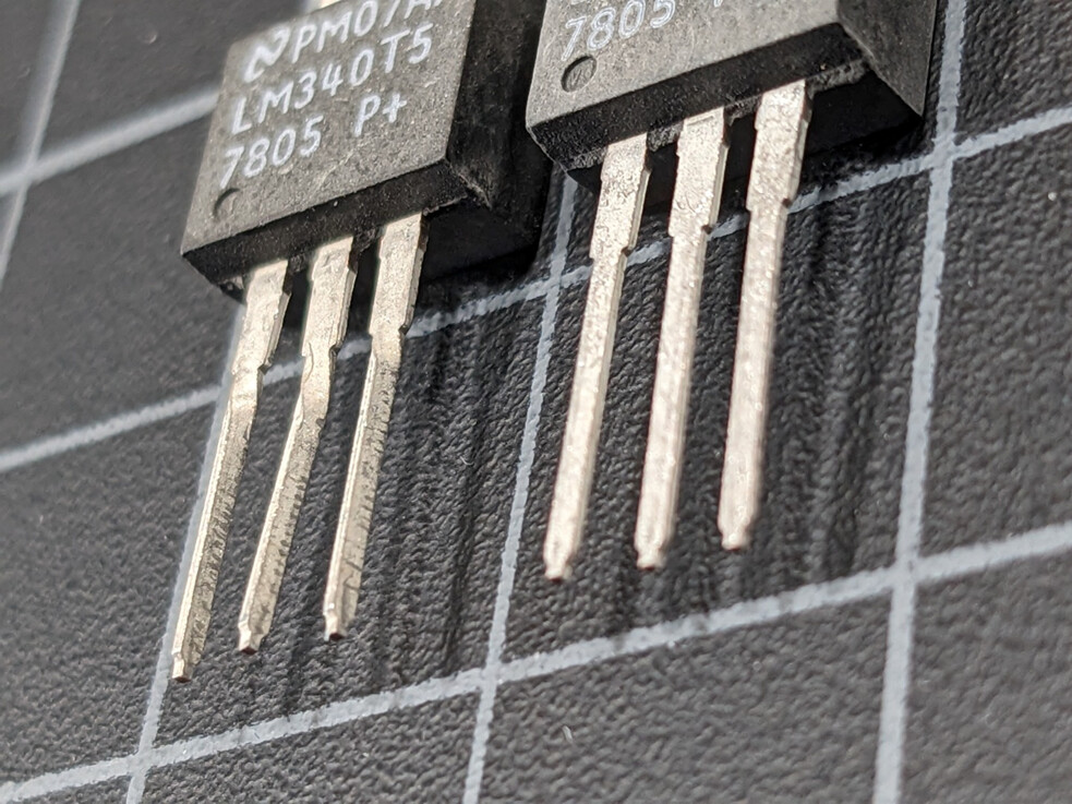

Obviously, we can’t reposition the TO-220 package with that orientation. However, we can twist the pins as shown in Figure 5 and video 1. This simple change – the twisting of pins – allows the TO-220 devices to easily slide into the breadboard.
Figure 5: Twisted leads (left) and original (right). Tool markings can be seen on the twisted leads.
Video 1: Short video showing how the LEDs may be twisted.
