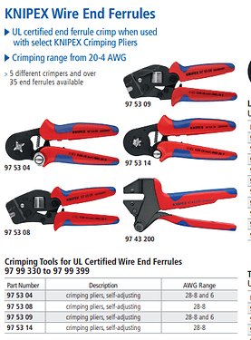

In searching for a crimping tool for wire ferrule connectors like 2172-9799375-ND (97 99 375), there are a few part numbers from Knipex Tools LP that they recommend.
Based on the supplier’s documentation, the crimpers that will work with this product are listed in the snip below:
Knipex Crimping Tools
2172-975314-ND (97 53 14)
2172-975304-ND (97 53 04)
2172-975308-ND (97 53 08)
2172-975309-ND (97 53 09)
