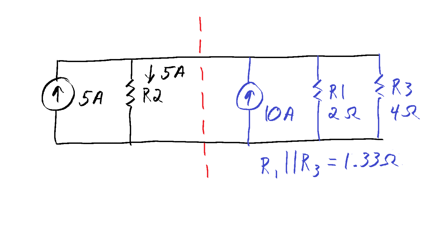

This is a counterexample where it is best to avoid the current divider equations. Instead, we will split the constant current source into two pieces as shown in Figure 1:
  • To the left is a 5A source along with R2
  • To the right is the remaining 10 A along with R1 and R3
Figure 1: Hand sketch of the circuit with the constant current source split into two.
Tech Tip: Recall that constant current sources may be operated in parallel. This fact allows us to conceptually split the current between two or more constant current sources. This little trick can help us visualize the circuit’s operation and help us solve the equation faster.
Techniques such as this are central to the engineering mindset. Don’t automatically jump to the equations if there is an easier way to solve the problem. It also helps us verify the problem as we have a deeper understanding of the interaction between elements.
Conceptually, this allows us to disregard the circuit to the left of the red line. With a 5 A source and a 5A load as R2, there is no current flowing across the red vertical line. However, the two sides of the circuit are still connected and so share the same node voltage.
We then solve for R2 using these steps:
  1. With 5 A flowing through R2, we observe that R1 and R3 carry the remaining 10 A.
  2. R1 in parallel with R3 is 1.33 Ω.
  3. The voltage drop is the same across all parallel elements: 10 A x 1.33 Ω = 13.3 VDC
  4. The new R2 value is 13.3 V / 5 A = 2.67 Ω
