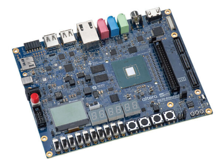

DE-25 FPGA Dev Kit Additional Setup Part 2 (The Road to Zephyr Agilex™ 5 Simics Virtual Platform)
The Agilex™ 5 Simics Virtual Platform can be used to simulate the DE-25 system running the old school Zephyr RTOS. This series of articles will illustrate how to setup the Agilex™ 5 Simics Virtual Platform that is relevant to the DE-25 FPGA Dev Kit,
The Agilex™ 5 Simics Virtual Plafform is shown below,
