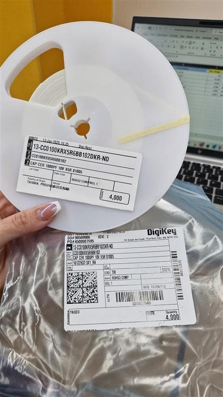

              My QC team is asking for Datecodes on  parts shipped as DigiReel. Why would this information not be included standard?
              Thank you for your inquiry.
I’m looking at the template for a DigiReel label, it should have date/lot code included standard.
              I agree with Kristof. There was a newer post created back in 2022 called Newer Digi-Reel Construction that lists (date/lot codes and country of origin) will become standard once migration is complete
              Recently encountered 3 examples of  date code missing, one of them pictured  here.
Add im
ages
              We recorded the date/lot code of that batch at the time of order, it should have been printed on that label.
I’m direct messaging you with the date/lot code information we have for that.

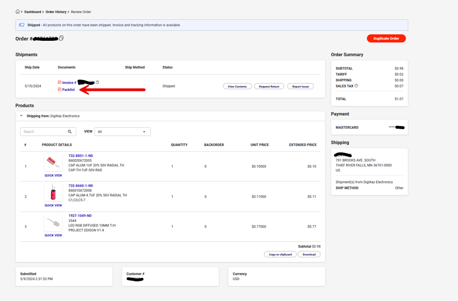

Also, the date, lot code information if available should be available within the Packlist:
