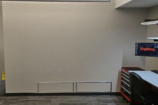

What have we put together at DigiKey for our 3D Printer Wall?
The shelving used is extra from our warehouse and is easy to adjust if and when we need to. As the shelving is steel it is able to hold plenty of weight and allows the use of magnets for aesthetics and lighting. The dimensions for one unit is 24 inches (61 cm) deep and 36 inches (91 cm) wide. The total height available is 99 inches (251 cm).
The shelf spacing chosen for the 3D Printer Wall is 12 inches (30 cm) for the bottom row, 24 inches (60 cm) for the next row, 26.5 inches (67 cm) for the middle row and 21 inches (53 cm) for the top row.
The height was selected based on printers that are currently in use and planning for the future.
Adding the first printers to the 3D Printer Wall.
Powering the 3D Printer Wall
Three 120V 20A outlets have been installed into the wall behind the shelves for powering the printers, SBCs, lighting. With the current max of nine printers set to be used, three PDUs were installed 603-2021-ND.
The PDUs were mounted to the below the shelfs that the printers and connected devices would be on. This allows the power cables to be managed easier and to allow others to connect/disconnect printers easier for the top shelves.

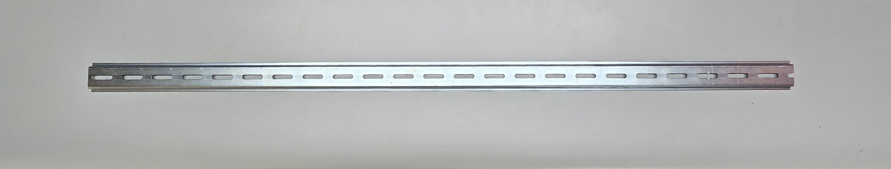

To brighten up the corner and attract attention, a lighting solution was needed. For the meantime white lighting is all that is needed. The LED strips come on a reel and are mounted with the adhesive backing to steel DIN rail. As the DIN rail is steel, magnets were used to mount them to the underside of the shelves. This not only allows them to be moved around and taken down if needed.

DIN Rail
ADR3575-S3300-ND

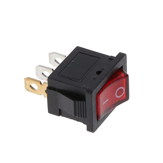

Illuminated SPST Switch
2057-SW-R2-1A-F-LR13-2-ND

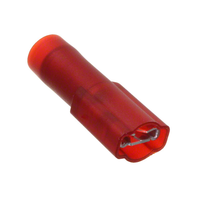

0.187 Inch Quick Connect
3M156217-ND

First place the DIN rail facing down

Next take the measured length from the LEDs to the switch location and crimp ferrules onto the wire that will connect to the LEDs. On the other end of the wires at the switch, crimp the quick connects on to each red wire. With the black wires, twist the stripped wires together, insert them into the quick connect and then crimp the wires.
Wiring the Switch
The switch plate mount was created to fit the switch and is attached to the shelf with magnets.
Magnetic Switch Plate.stl (12.2 KB)
With the switch orientated as above, connect one red wire to the middle and the other to the bottom. The joined black wires are to be connected to the top connection (brass terminal). When the switch is switched to the on position, it will be illuminated. If a non-illuminated switch is used, cut a break in the red wire and tie in the switch.
