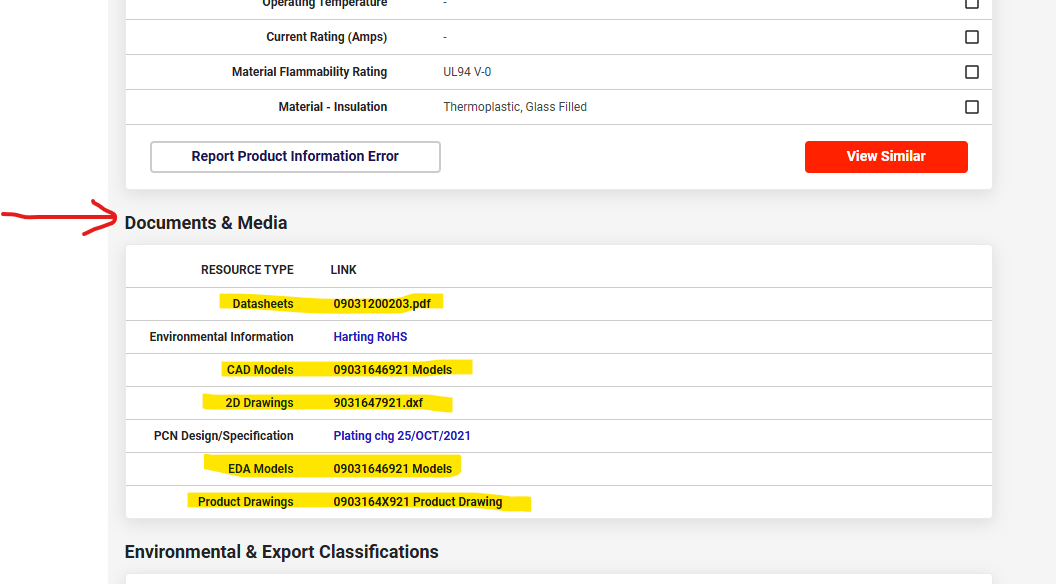

Finally, before ordering a part, it’s highly recommended that one looks at all of the available documentation associated with the part. There’s generally a “datasheet” which may or may not give much in the way of diagrams and dimensions – this varies significantly from vendor to vendor. But often there are additional documents, either linked from within the datasheet or found further down the “Documents and Media” section. There’s often a separate pdf drawing and CAD models available which can help in verifying that the part is what you expect it to be.
