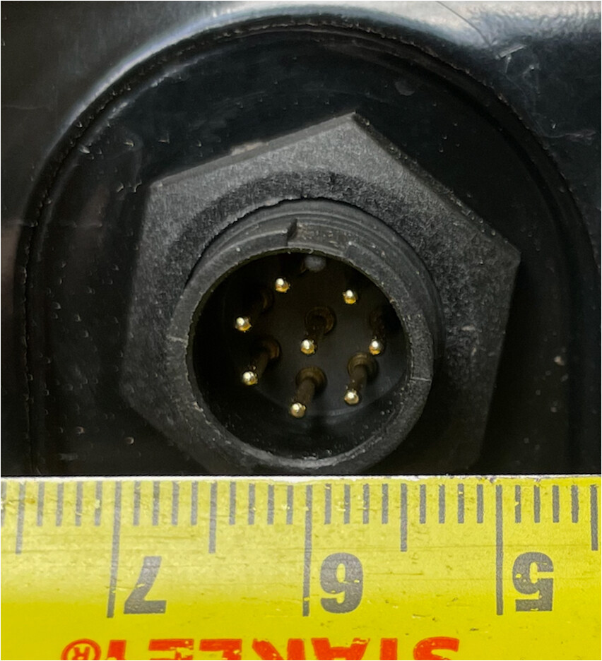

Finding match for 8 pin male din
I’m looking for a matching female connector for the attached 8 pin din. It’s clearly A-coded but dimensions don’t seem to match anything I can find. It’s a push fit but I’d be open to make other types work if pins fitted.
Tape on picture is marked in cm.
Thanks in advance for any help.
That looks like the Amphenol LTW circular waterproof connector series.
See if you can find your part in these 7 search results, then it should be easy to find the mating female connector options.
Here is the closest options I can find.
Thanks Paul, these are really close but the inter pin distances don’t quite work out.
Thanks Kristof, it looks like Conxall/Switchcraft 7282-8PG-300 is a good match. I’ve ordered a mating connetcor through DigiKey and crossed my fingers.
Conxall/Switchcraft 7282-8PG-300 arrived today and it’s a perfect fit. Thanks for your help!
