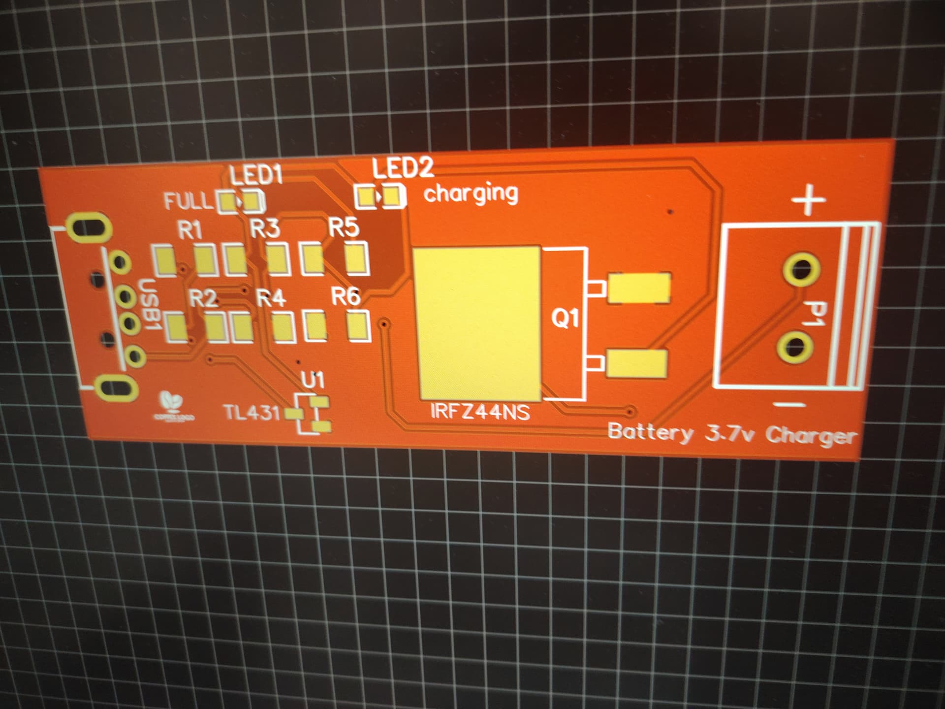

Discussion of the battery charging project
This is a battery charging project. Please give me your feedback on the project.

Charges a 3.7 volt battery
Am i seeing what i think I’m seeing? Do not plug this into anyone’s laptop! What voltage did you set on the TL431 “Voltage Reference” to drive the Charging voltage? Where’s your USB protection, current limit, etc..

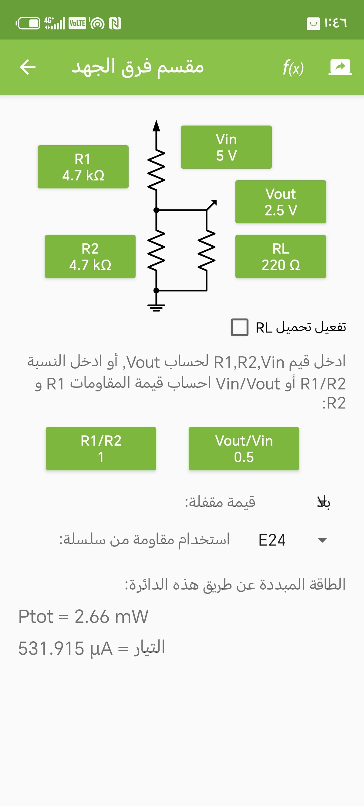

Mr. Engineer, the voltage divider on two 4.7 kOhm resistors is on the 2.5V voltage regulator.
@sikwal
For verification, Would you have a link to the specific “TL431” you are using?
Dear Engineer, the electrical circuit you made is 100% correct. I made the project on 2012 /12/01. I applied it to the TL431 2.5 volt regulator, and it is a correct application. Dear Engineer, would you like to have coffee with me? Dear Engineer, I hope to see you face to face. I do not have I had electrical programs, but my children messed with them and the programs were lost. But I promise you, the circle is in reality, my dear.a link. I have programs that use lt431.
