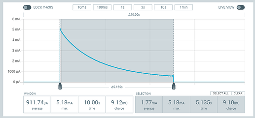

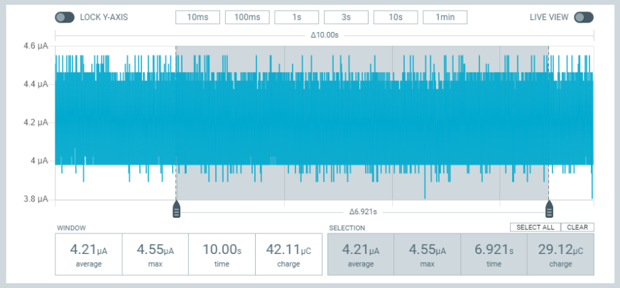

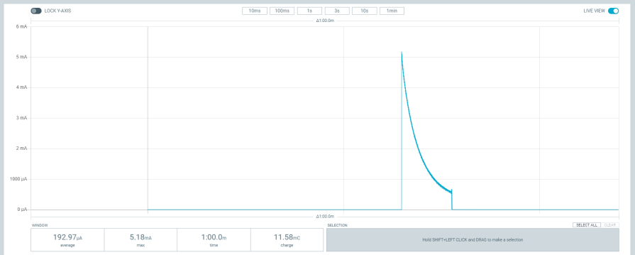

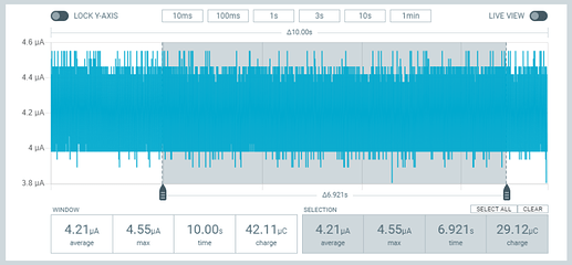

Below PPK2 screenshots show the IoT sensors current consumption.
Figure 3. IoT sensor current measurement
Figure 4. IoT sensor wake average current measurement
Figure 5. IoT sensor sleep average current measurement
Based on above measurements, average current during a wake period is 1.77mA over a duration of 5.135 seconds and average current during a sleep period is 4.21uA over a duration of 60 seconds with a total wake/sleep cycle period of about 65 seconds. This calculates to an approximate average current of 0.142mA. Based on battery capacity of 2100 mAh (to a cutoff supply voltage of 2.1V), battery life of the IoT sensor is estimated to be about 1 year and 8 months.
