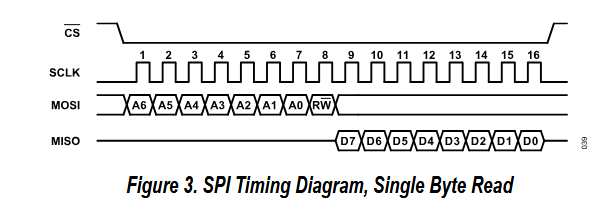

Can you explain why to transform the register address like this? It doesn’t seem to match the format specified in the datasheet:
I’d expect to see something like
uint8_t cmd = (reg << 1) | 0x01;

Hi @rhamlin,
OK, so I understand the protocol as you described it. But I’m still not understanding why you’re using it. The SPI protocol understood by the ADXL372 is described by the timing diagrams in Figures 3 – 6 in the datasheet. Anything else you throw at it won’t be recognized as valid input…
Thanks for sharing the spec doc, and the SPI timing.
For some reason, that clarified everything for me. I see that I made a mistake previously, and that the SPI “command byte” is [A6…A0 | R/W], with the R/W bit as the LSB. So there’s no “MB” (multi-byte) bit; and burst reads/writes happen simply by holding CS low and clocking more bytes (the address auto-increments) while using SPI mode 0 (CPOL=0, CPHA=0).

So everything is working as expected!!
