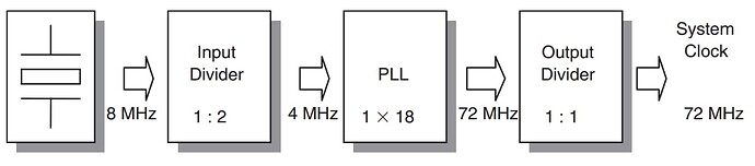

The Primary Oscillator Clock Chain
The clock goes through a number of stages before it is used as the system clock. These stages let you choose which frequency you want to use for your application. The figure, from Lucio Di Jasio’s book, shows the three stages that the clock goes through.
The first stage is the input divider. Next is the phase locked loop circuit (PLL). In order to work, the frequency must be between 4MHz and 5MHz before entering the PLL, so we must use the input divider to divide the 8MHz internal oscillator by two. The PLL circuit will multiply the frequency. The last stage is the output divider and after that you have the system clock.

This menu is amazingly helpful and will speed up the clock configuration process. The most important columns on this menu are the far right two. “Category” tells you what you are changing and “Setting” tells you what you have changed it to. In this guide, we will be using the fast internal RC oscillator to make the system clock run at 20MHz. We will also be using this frequency to run the peripherals as well. The options that we will be changing from the default are listed below
- The oscillator runs at 8MHz, but we need it to be between 4MHz and 5MHz to enter the PLL, so we must choose “2x Divider” for the input divider option.
- Choose “20x Multiplier” for the PLL Multiplier option.
- Choose “PLL Divide by 4” for the output divider option. After the input divider, the frequency is 4MHz. After the PLL multiplier, the frequency is 80MHz, so we want to divide by 4 to get to 20MHz.
- Select “Fast RC Osc with PLL” for the oscillator selection option.
- Disable the secondary oscillator.
- Disable internal/external switch over.
- Select “Pb_Clk is Sys_Clk/1” for the peripheral clock divisor option. This will make the peripheral clock run at the same frequency as the system clock.
- Disable the watchdog timer.
