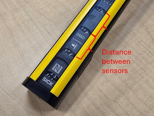

  • In the first image, we see the close-up of a SICK light curtain. The individual beam lenses are clearly visible, allowing us to measure the distance between parallel beams

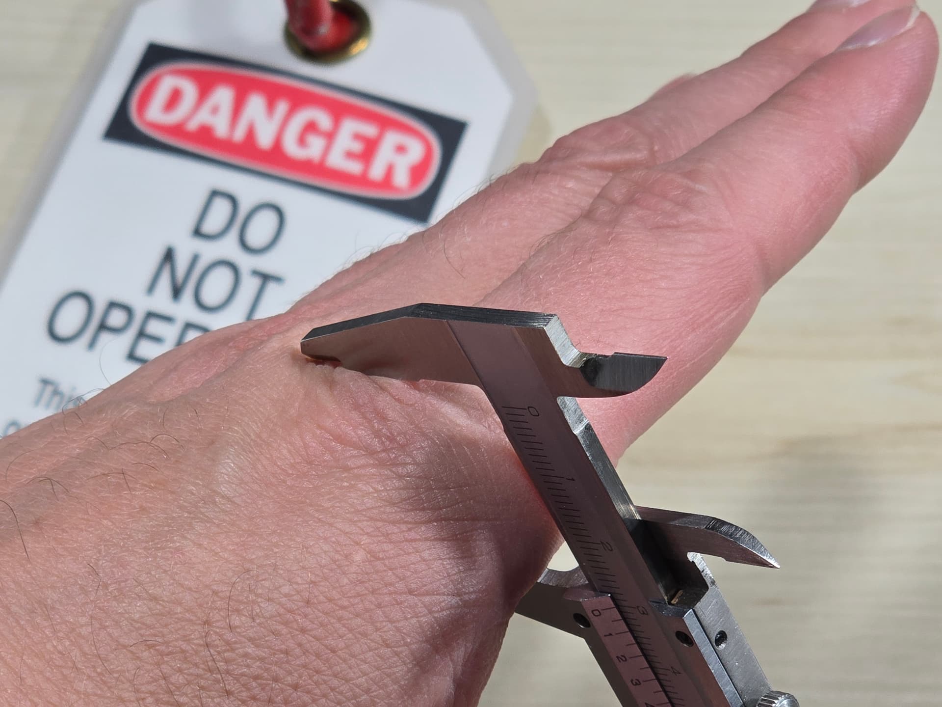

  • The second image shows a comparison between the author’s hand and a caliper set to 30 mm. The author has relatively large hands with 30 mm at the knuckle.

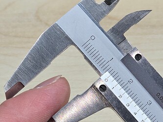

  • The third image shows the author’s finger as compared to a caliper set to 14 mm.
Figure 1: Close-up image of a SICK light curtain showing the individual lenses with 30 mm spacing.
Figure 2: Author’s knuckles as compared to a 30 mm gauge.
Figure 3: Author’s finger as compared to a 14 mm gauge.

In this example, the author could insert his hand up to the knuckle before triggering an emergency stop. A smaller person, or child visiting your facility, may be able to reach all the way to the wrist or even forearm before triggering the emergency stop. This is an important safety consideration as we need to protect everyone, not just the (mostly) predictable operator and technicians.

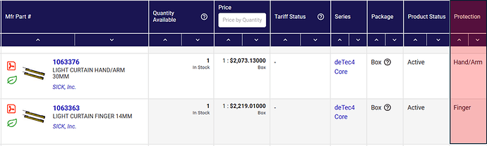

DigiKey’s parametric search engine classifies a light curtain as either “Hand/Arm” or “Finger” as highlighted in Figure 4. To understand the distinction, we will perform a case study using representative SICK light curtains, including:
Differential comparison between a finger and hand designate light curtain
To better understand the distinction, we use DigiKey’s compare function and then select for fields that are different between the two curtains. As shown in Figure 5.
Figure 4: DigiKey parameters for SICK light curtains with the protection field highlighted. Prices are accurate as of July 10, 2025 but are subject to change. Please follow the previously mentioned product links for the latest price.
Figure 5: DigiKey product comparison (delta) between the finger and hand designated light curtains.
Observations
  • The beam distance metric is located in several places:
    • 14 mm for finger
    • 30 mm for hand
  • The finger protection light curtain is slightly more expensive. This is natural as there are more beams for a given light curtain length.
  • The valid sensing distance is reduced. Even with quality lenses (Figure 1), the light will spread. Beam separation is vital for this SICK deTECH light curtain.
