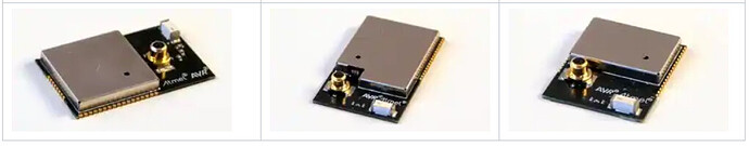

Atmel provides a variety of wireless MCU solutions in the 802.15.4 platform. They provide multiple RF transceiver solutions in the 2.4GHz band and the 700/800/900MHz band. These radios can be very easily interfaced with any of Atmel’s AVR or SAM microcontrollers through the digital SPI port. Atmel also provides single chip RF solutions which combine the microcontroller and RF transceiver into a single chip.
ZigBit modules combine these wireless MCU solutions with an approved antenna interface in an easy to implement platform. Using ZigBit modules can save the developer time and money by not having to pursue quite as much FCC testing. Atmel also provides wireless stacks and example code in Atmel Studio for these ZigBit modules. The purpose of this page is to familiarize the user with these modules and the differences between them.
Quick Comparison
| Type | ATmega256RFR2 ZigBit | ATxmega256A3U / AT86RF233 ZigBit | AT86RF233 Amplified ZigBit |
| Part Number | ATZB-S1-256-3-0-C | ATZB-X0-256-3-0-C | ATZB-RF-233-1-C |
| Datasheet | Datasheet | Datasheet | |
| Schematic | Schematic | Schematic | |
| Development Tool | ATZB-256RFR2-XPRO | ATZB-X-233-XPRO | ATZB-A-233-XPRO |
| Documentation | Documentation | Documentation |

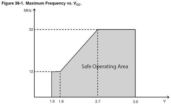

Unlike the ATmega256RFR2 ZigBit, the ATxmega256A3U Zigbit core clock source can be safely changed at run-time. The device core can be clocked by the following on-board sources:
- Internal 32MHz RC Oscillator
- Internal 2MHz RC Oscillator
- Internal 32.768kHz Oscillator
- External 32.768kHz crystal oscillator
- CLKM output from Radio (1, 2, 4, 8, or 16MHz)
- Internal PLL with 1-31 multiplier
Additionally, the following clock sources can be used as inputs to the PLL:
- Internal 32MHz RC Oscillator divided by 4
On power-up or after power-on-reset, the internal 2MHz oscillator is always selected as the system clock source. The clock source and prescalers can be changed at any time by software.
See the figure below for maximum core clock frequency vs. Vcc.

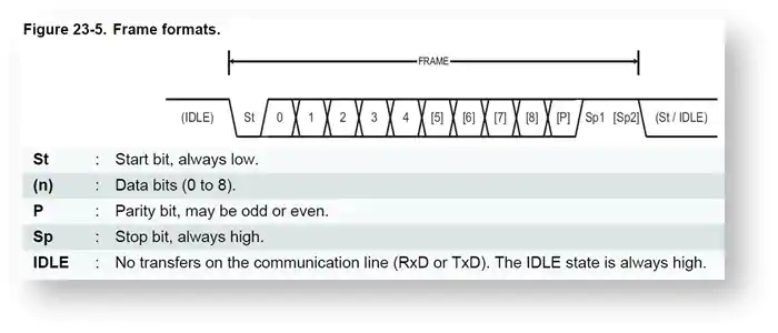

Tutorial - USART - Asynchronous Mode (UART)
UART Background
UART communication is a very simple and inexpensive method of serial communication in embedded designs. UART communication in full-duplex mode uses one pin for Transmit (TX) and one pin for Receive (RX). Half-duplex uses a shared pin for TX and RX (commonly referred to as single-wire UART or 1-wire Comm). Both versions require a common ground to operate properly.
Since there is no shared clock line, the data rate needs to be setup on both ends of the communication link ahead of time. The receiver on each end uses oversampling to read each bit of incoming data. The oversampling rate is dependent on the desired baud rate being used. Asynchronous communication commonly fails due to sloppy reference clocks. It’s normally recommended to use some sort of high accuracy clock like a crystal oscillator, or a calibrated RC oscillator as the reference clock. Generally, reference clock accuracy becomes more and more important at higher baud rates.
The following image was taken from the ATmega256RFR2 datasheet (Sec 23.4). It shows the frame format for UART communication.

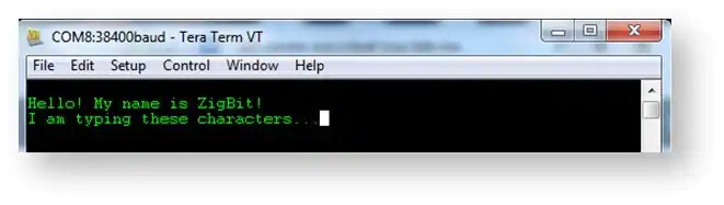

- In the terminal window, you should see a test string printed. You should also be able to type characters and have them echoed in the terminal.
Below is a screenshot of the Tera Term window while running this application.

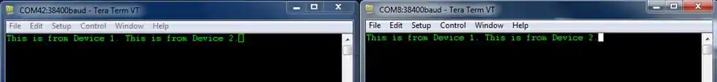

- Begin typing characters in the 2nd Tera Term window. If both boards are powered up and within range of each other, characters should appear in both Tera Term windows. If not, try resetting the boards.
Below is a screenshot of the two terminal windows connected to the wireless devices:
The following image was taken from the ATxmega256A3U datasheet (Sec 23.4). It shows the frame format for UART communication.

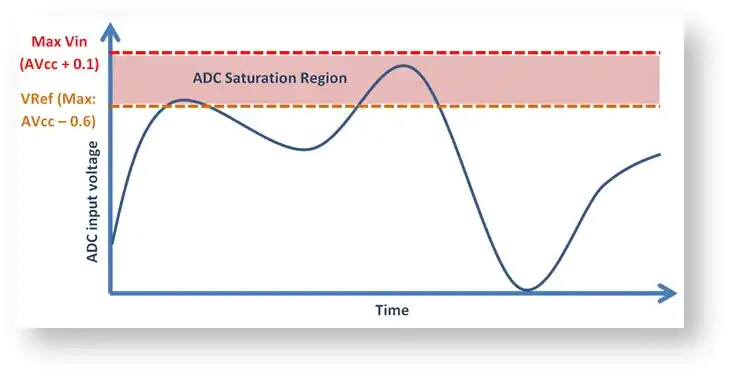

According to the electrical specs for the ATxmega256A3U, the min and max voltage applied to any ADC input are -0.1V and AVcc+0.1V, respectively. However, the maximum ADC Reference voltage is AVcc-0.6V. Therefore, even with the maximum allowable reference voltage, any voltage above AVcc-0.6V will saturate the ADC. The following figure illustrates this point:
Any ADC input voltage in the pink range will read 0xFFF for unsigned results and 0x7FF for signed results (assuming 12-bit operation). What does this mean for us? It means any voltage in the pink region applied to the input of the ADC is electrically acceptable. However, it is useless because it will always return the same digital value. The reader should note, a similar Saturation Region exists on the low end as well. However, this region is defined by the negative input of the ADC and is configurable by the user. Refer to section 28.3 of the XMEGA-AU manual for details on input sources.

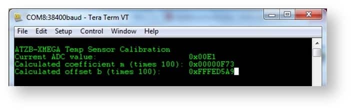

The following image is a screenshot of the terminal window while running this application at room temperature (25C).
This program takes an ADC reading at the current temp and calculates the coefficients m and b for you. You will need to define the current temperature in application code. Once you have the values for m and b you need to define these coefficient values in the second program.
Why did we multiply by 100? Multiplying by 100 saves us from integer drop off when we are dividing numbers. This helps us maintain 2 decimal points of accuracy. If we wanted 3 decimal points of accuracy, we’d multiply by 1000. Just make sure your variables are large enough to store the values! We correct the result by dividing by 100 after the calculations are done. - Now download the following ATZB-XMEGA_Temp_Meas_Example project for Atmel Studio 6.1

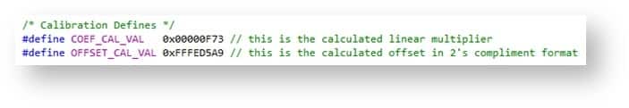

- Make sure you adjust the coefficient definitions to match what was calculated for your device. The definitions are located towards the top of ATZB-XMEGA_Temp_Meas_Example.c. The following screenshot shows the definitions corresponding to the result of the first program (shown above):
