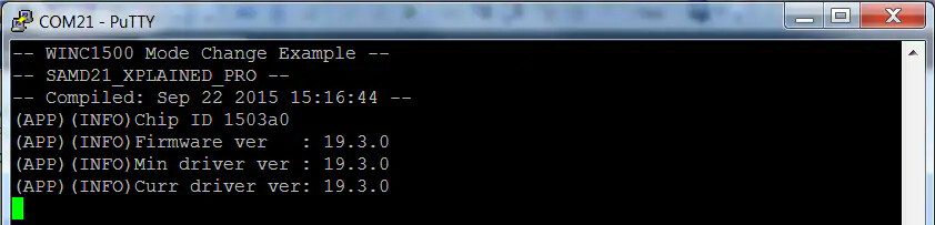

Once the terminal window is open, press the reset button on the SAMD21 board.
You should see a message similar to the following:
Every time you push the button SW0 on the SAMD21 board, the Winc will enter a new mode. After two presses, you should see the following message on the terminal.
