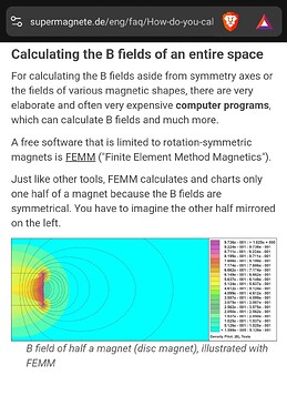

It’s not clear how sensitive of a hall effect switch to order, or how far to place them from the magnets, or what calculations and or measuring devices are best to answer this for myself through math and experimenting.
Hall effect switches sensitive to magnetic field inductions, different sensitivities, designs, structures

The distance of the sensor can mostly be something you pick. I would recommend choosing a range of distances and find the magnetic strength that should be expected for that range of distances. This is so that when you are looking for the sensors you can have a higher chance of finding one that can fit any of the other specifications and also still work with the distance that you find to be accept able for your needs.
In the below link it shows the sensors found on our site. We list the trip and release values for the item we have. once they are selected then I would recommend looking over the variables to see what other decisions that need to be made for your design.

You can directly test the strength values using a meter tool as shown in the below link.
I would recommend looking at the ones that that the probe that you can use to be more direct in where you are thinking you would like the senor to be relative to the rest of the device.
