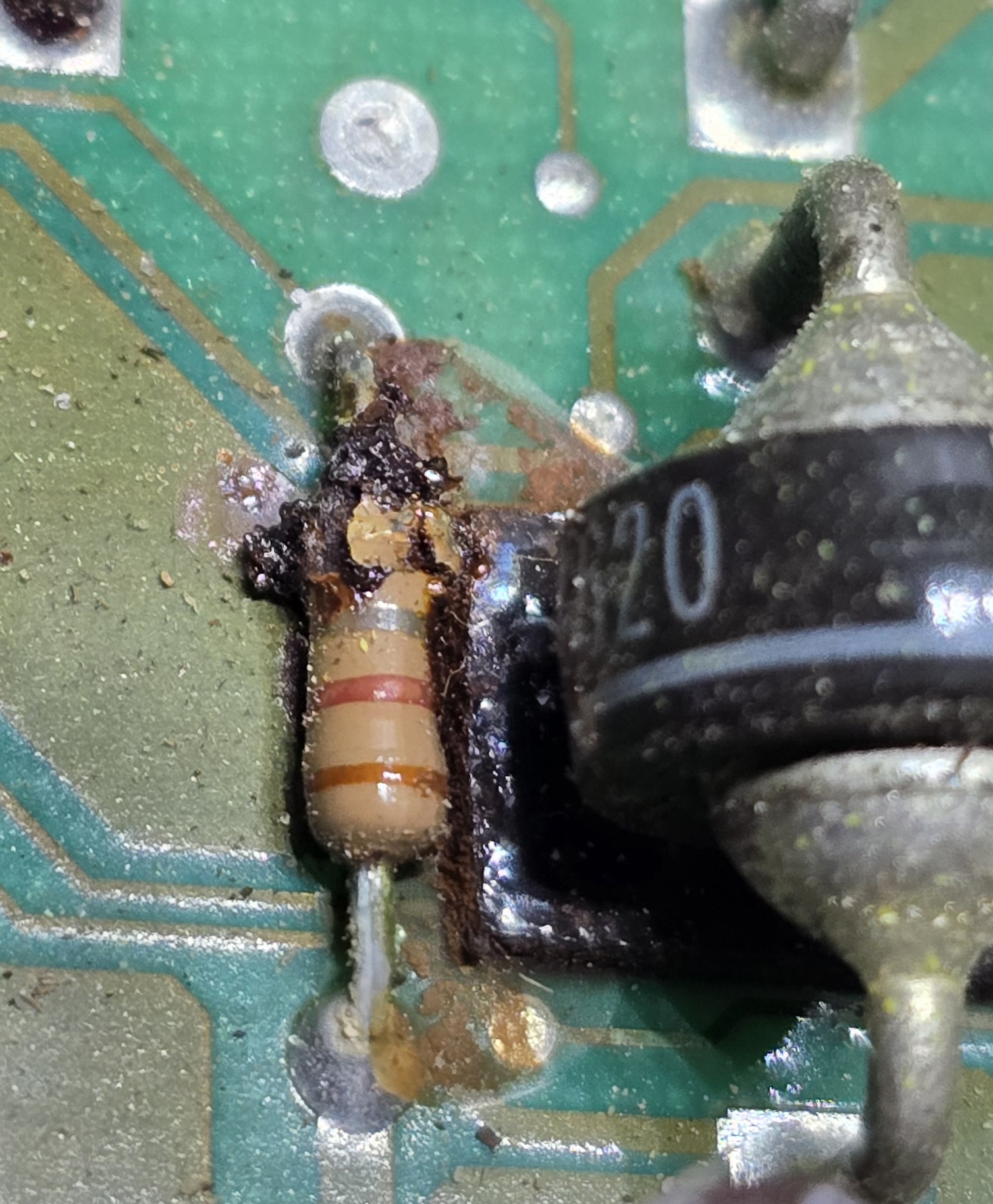

First time here, I’m trying to teach myself how to repair electronics and I’m working on an eec from an old ford truck. I opened the computer to find a burned resistor
Can somebody please help me id this resistor?

Hello, mmoreno3086.
Brown, Red, SIlver, Gold
0.12 Ohms 5%
Resistor Color Code Calculator - 4 band, 5 band, 6 band | DigiKey Electronics .
Thank you so much for the reply.
I checked using the calculator and it doesn’t show DigiKey carries this resistor?
Where can i find one?
Hello mmoreno3086,
DigiKey has some options for this. The 0.12 Ohms = 120m Ohms.
Click here for 13-FMP100JT-52-0R12CT-ND, which is rated for 1W.
If you want a lower wattage, we also have 13-MFR-25JR-52-0R12CT-ND, which is rated for 1/4W.
Both of these are 0.12 ohms, and 5% tolerance, and can be purchased down to 1 piece.
