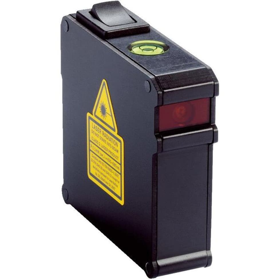

This engineering brief describes practical light curtain alignment concepts. The focus is on the SICK deTec4 series light curtains as shown in Figure 1. It assumes a laser alignment aid is built into the light curtain. Related SICK light curtains such as the deTec4 Core may require the use of an external alignment aid such as the SICK AR60 1015741 shown in Figure 2.

Figure 2: Image of the SICK AR60 laser alignment tool.

The SICK deTec4 is align using the integral laser alignment aid. In an ideal setting:
Activate the integral laser alignment aid
The initial goal is to move the light curtains so that the alignment laser strikes the midpoint between the status LEDs as shown in Figure 3. This may require movement on multiple axes as shown in Figure 4. It may be necessary to move both sender and receiver.
Finely adjust the light curtain as necessary until all indicator LEDs are activated. This includes the cluster shown in Figure 3 plus an additional four near the top of the unit (not shown).
Verify the health of the light curtain using the networked connection (e.g. IO-Link) or use your cell phone’s Near Field Communication (NFC) feature along with the SICK Safety Assistant App.
Clamp the light curtains into position so that they remain in place even if inadvertently bumped.
Tech Tip: As stated in the datasheet: The integrated laser alignment aid can be controlled either via a switch or pushbutton on the sender or via a sender-receiver connection (Safety Designer, IO-Link, SICK Safety Assistant, alignment mode).
The pushbutton shown in Figure 5 provides a convenient way to activate the integral laser alignment tool, especially in a classroom setting. Select the appropriate button for your cable configuration:
