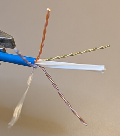

Prepare the Cable
- Strip about 2 inches of the outer jacket.
- Trim any nylon cord and cable separator if present.

Position the Wires
- Guide each twisted pair into the correct slot on the cap using the printed diagram.
- Do not untwist or rearrange wires as they should match up with the cap color codes

Terminate the Wires
- Do not untwist more than necessary.
- Guide each conductor into the correct slot on the cap using the printed diagram.
- Keep the twists as close to the termination point as possible for optimal performance.
- Once terminated correctly, Using your Flush cut side cutters, trim off the excess wire.

Tips for Best Results
- Avoid excessive untwisting of pairs, as this can affect signal integrity.
