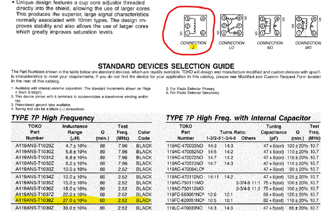

I confuse how to wire the adjustable inductor with 5 pins (T1038Z) (link below) to the breadboard? which is the role of each pin ?
