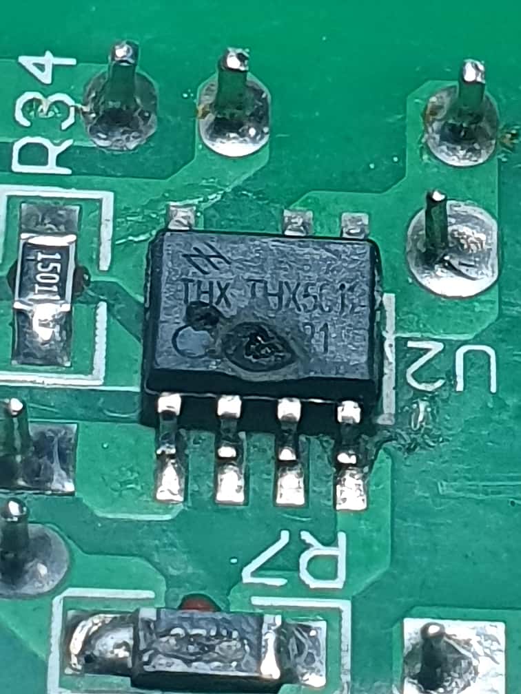

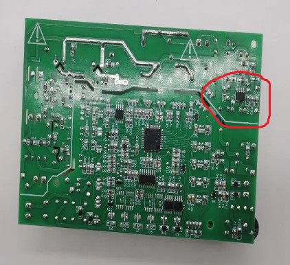

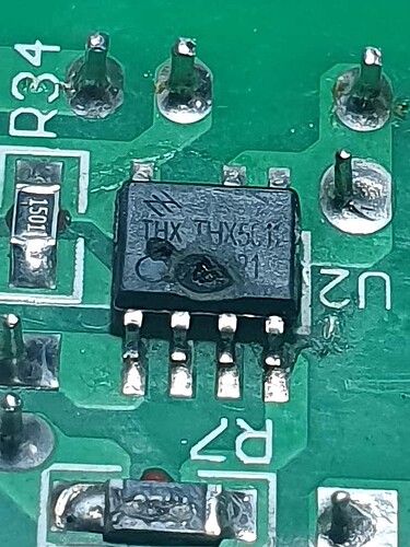

I need help identifying this IC from Hyundai HY-KFTBS8T-001 is an automatic espresso machine
Unfortunately, I could not identify this IC.
I put it under a microscope and it says THX5011 but I can’t find this circuit even with an equivalent :frowning:
Logo appears to be for a supplier out of china called THX microelectronics, and the context would suggest that it’s an integrated flyback supply controller. Unfortunately there’s not a lot of standardization among similar products in that realm, so the likelihood of finding a workable substitute handily available in more western localities is not good.

This is the THX501 from THX Micro-elec company (TongHuaXin).
For more information, visit the manufacturer’s website:
Thank you very much for your answer, all the best!
