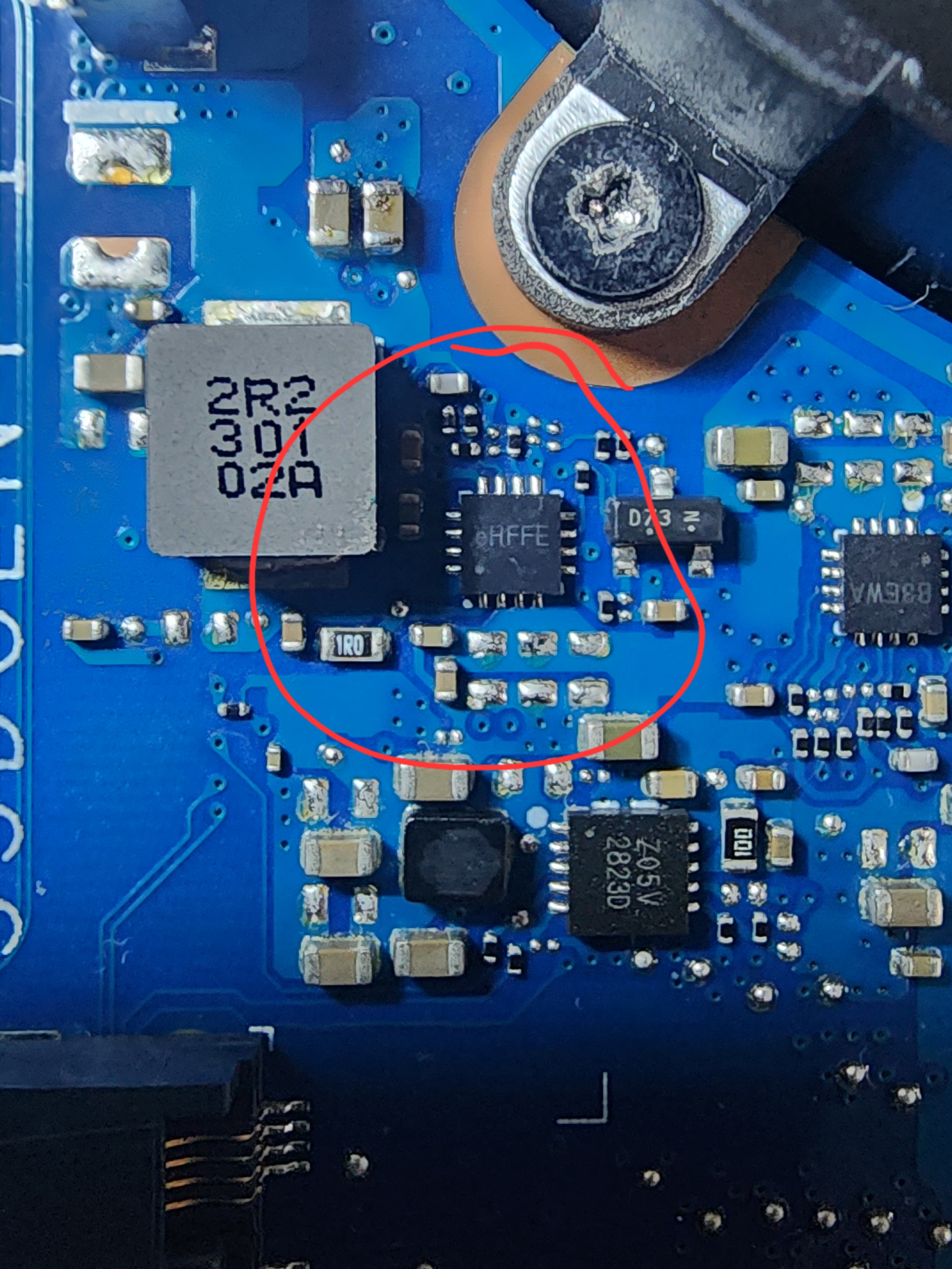

Identify a laptop IC (eHFFE)
Hello defcon5,
Welcome to the DigiKey TechForum! I was unable to find anything with eHFFE markings that would allude to a specific part or series. In researching the surounding components on the board, however, it appears to likely be a voltage regulator. To determine the manufacturer and part number of the IC, you will want to consult the laptop manufacturer’s documentation or inquire with them directly.
Regards,
Klint
Hello, defcon5.
It is SY8386RHC
High Efficiency Fast Response, 6A, 28V Input Synchronous Step Down Regulator
eHxxx-SY8386RHC.pdf (348,6 КБ)
