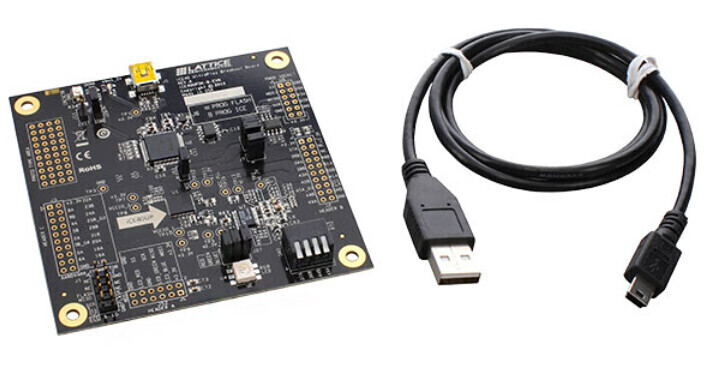

Lattice ICE40 UltraPlus Breakout Board (Demo of SPI Soft Core)
The present article will demonstrate how to implement a SPI soft-core via Verilog HDL that will serve as the main conduit for controlling the internal finite state machine inside the Lattice ICE40 FPGA UltraPlus Breakout Board.,
This demo is composed of a host C program the computer compiled on Linux that will communicate with the Lattice ICE40 FPGA UltraPlus Breakout Board., via the FTDI chip on the breakout board. The Lattice ICE40 FPGA UltraPlus Breakout Board. will implement a soft 4 wire SPI slave HDL that will serve of the communication method between the host and the Finite State Machine inside the FPGA. Here us a block diagram of this demo,
The SPI soft-core module is defined in the spi_slave.v Verilog HDL module shown later. Communication is done with packets of 4 Bytes. The first byte is the opcode on the MOSI line, on the MISO it is a status byte. The two other bytes are used for data. These opcodes are implemented:
