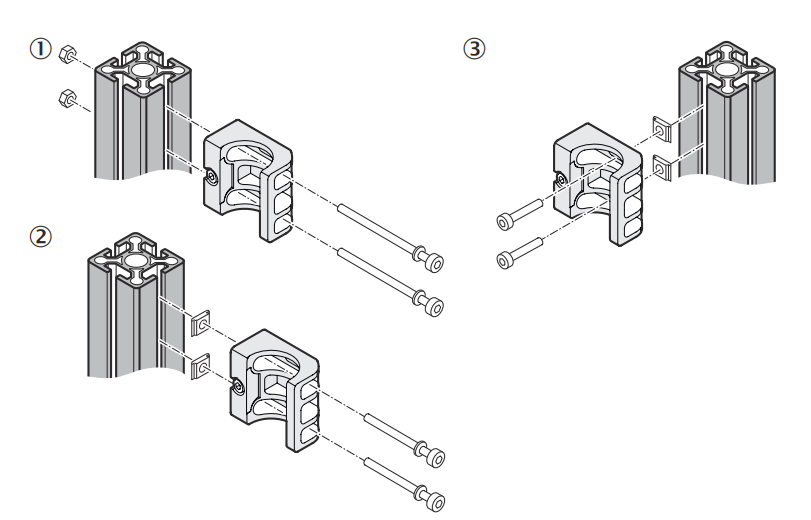

Figure 2 from the SICK deTec4 Core operating instruction manual suggests a few options. We could flush-mount the light curtain (option 3) directly in the machine’s window. Alternatively, we could side-mount the curtain (options 1 or 2) so that the curtain components are mounted on the front of the machine. The second option may be optimal, as the curtain components are shadowed from the welding arc and the operator is less likely to strike the light curtain when removing material from the work cell.
Figure 2: Installation options for the FlexFix bracket.
