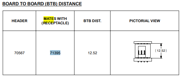

I am using 0705670171 in my PCB .I couldn’t able to find mating part for the same. Kindly help to find mating part.
Part : 0705670171
Description : CONN HEADER VERT 6POS 2.54MM

Hi @navin.prasath
Welcome to the community!
As per the datasheet, the 70567 series is designed to mate with the 71395 series. Please check part 0713951006 also confirm all details in the datasheet for accuracy.
Hello Aayushi,
Thank you for your response .
I am looking for the mating connector which can be wire crimped or soldered and to be mated with 0705670171 part .
