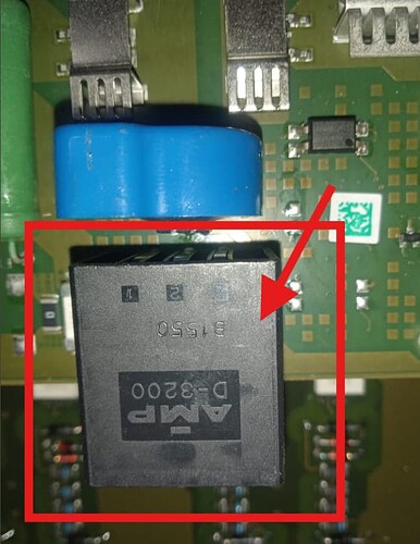

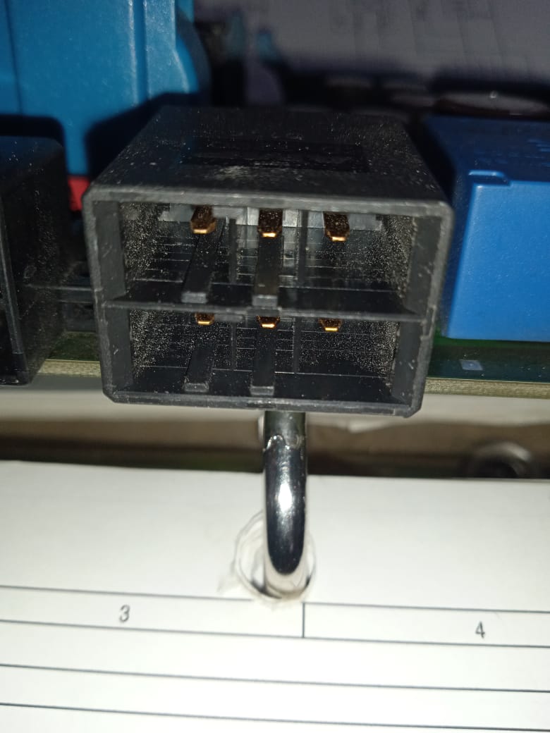

Hi.. I need information about the following connector, because I need a female connector for this connector. The connector is listed as AMP D3200 B1550, can you provide the part number for this product and where I can get the female connector?

This part appears to belong to the TE AMP Dynamic D 3200 series.
I’ve found related parts on our website—please check the link below and verify them based on the dimensions accordingly.
TE Connectivity AMP Connectors Header 6 Board to Board or Cable Through Hole Headers, Male Pins
You can also find mating parts listed at the bottom of each product description page.
