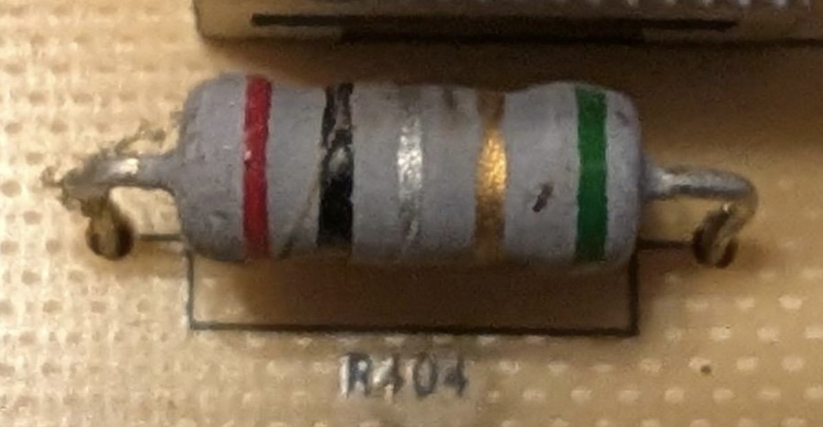

Need help identifying this resistor.
This second picture is from a good board. Which I do not have
Any help will be much appreciated Thanks

Hello Maltese302,
I am sorry to inform you that I could not find a guide for the silver band on the 3rd bar.
I think that these are proprietary markings. You might have to contact the manufacture of your device to get more information on the resistor.
Thanks. I kind off figure that after finding no info on it
If that silver color is in fact gray that resistor might be a 20.8 Ohm 0.5% value.
I wouldn’t be able to comment on what wattage it would have.
