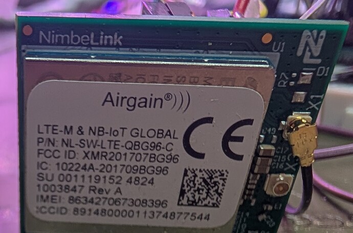

Need pinout for QBG96 & USB EMBD UART 3.3V .1"HDR
I purchased an LTE QGB96 (Airgain) device (1-20 pins). I am having difficulty sending and receiving AT commands from my Arduino sketch, so I was advised to buy a TTL-232R-3V3‎ USB Embedded UART 3.3V cable
.1 "HDR. The cable arrived, but I need guidance on how to interface the two for diagnostics.
Any help is appreciated.

I think this is what I am looking for. Will the TX be at the 3.3v level rather than 5v?
Correct, the TTL-232R-3V3 logic level is 3.3v…
Looks like you directly access the modem with pins 2, 3 and 4…
Regards,
Is pin 1 (grnd) and 3 (vcc) supposed to power up the QGB96 via port 1 (vcc) & 4 (grnd)? Not working for me.
Please don’t connect VCC from the TTL-232R-3V3 as it’s “VCC” from the USB bus (5v)..
TTL-232R-3V3 only changes the serial pins to be 3v3 tolerant.
Vcc (5v) can only source 75mA

Btw, which Arduino platform did you try to use when sending AT commands?
If your plugging into an Arduino, this kit would be very useful to make sure the voltages are proper: NL-SWDK2 Airgain | Development Boards, Kits, Programmers | DigiKey

Can I attach my sensors to the kit? My project uses three different vibration sensors and an sms message is sent if vibration is detected.
What and how may interfaces do these sensors use? i2c/spi/uart/etc? Pins/etc?
Regards,
They use pins A0-A2. Simple Analog sensors
You would lose A0 with this Arudino shield.
Regards,
Alright.. I will move to digital sensors instead… Thanks
