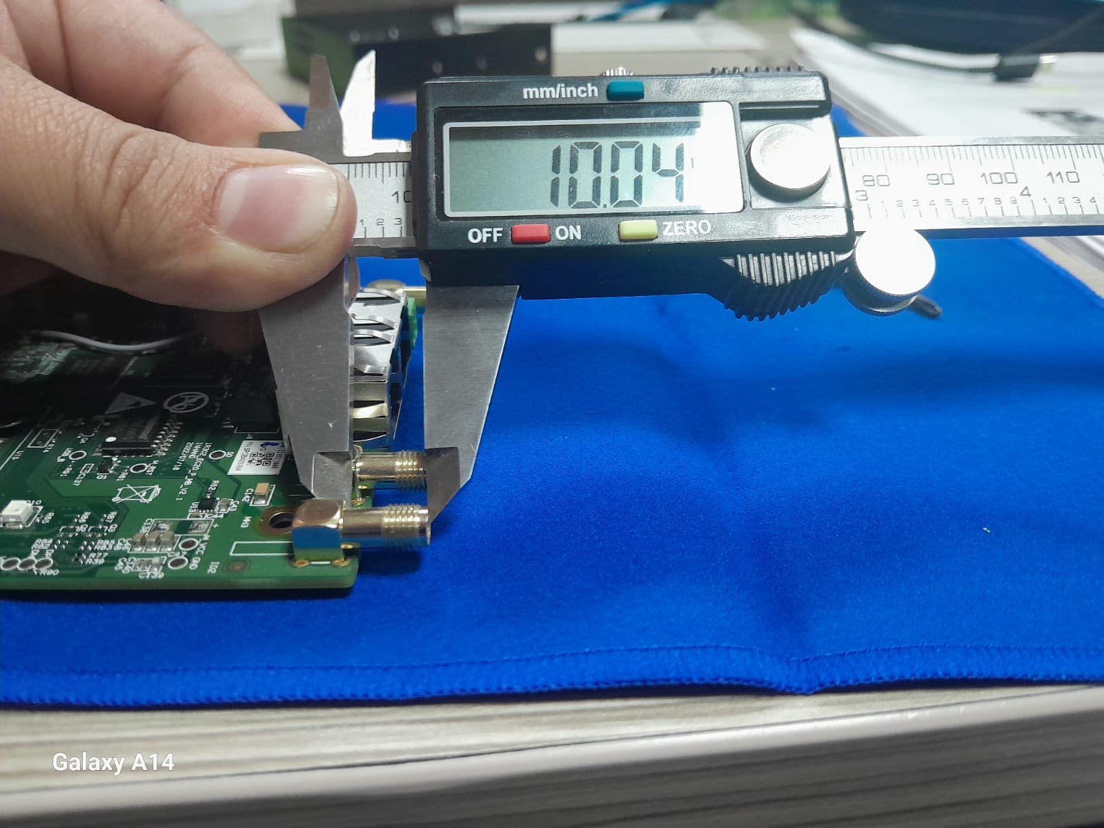

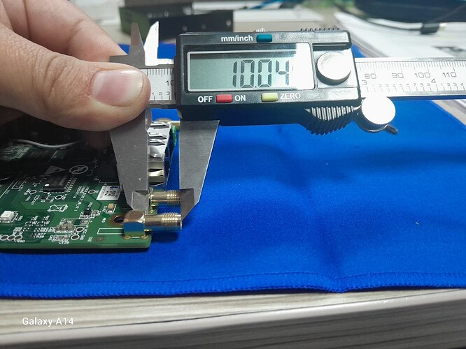

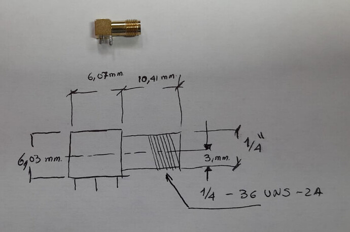

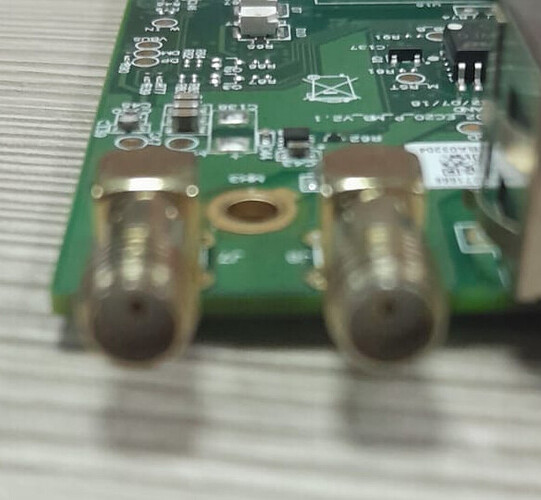

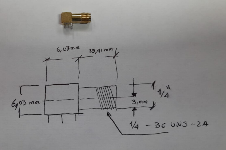

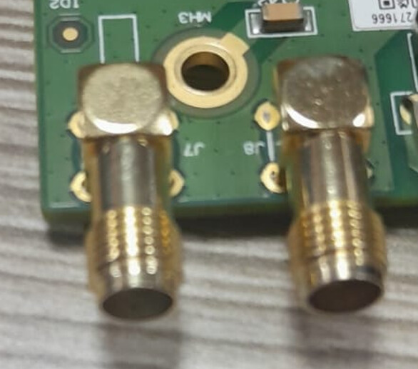

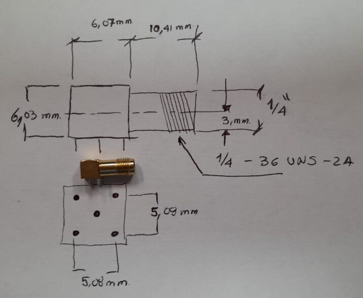

Please help me with the part numbers for the following connectors. Thank you!
Diameter: 6.30mm
Length: 10 mm
The coax connector looks like an SMA female Jack. I wasnt able to match it to one we carry however if the dimensions can be different, there maybe an option here that might work. Please look through the options and verify the datasheet before ordering.
Good morning. While reviewing the attached link, I was unable to access it correctly. However, I have taken the measurements of the connector and would like to request your assistance in verifying if it is possible to help us with the corresponding part number.
Thank you in advance for your cooperation.

Hi cvega,
Here’s another link which should get you to our selection of SMA receptacle options.
Things to note:
  • Your footprint is pretty universal for the four-pin right angle SMA connectors, so we have many parts which meet that requirement.
  • The connector face for an SMA jack/receptacle (the terms are synonymous) are standardized at 1/4"-36 UNS-2A, so all of these will also meet that requirement.
What is not standardized are the following:
  • Other connector dimensions
  • Internal and external materials used
  • Frequency capabilities (for example, the max frequency for SMA connectors in link provided range from 2 GHz to 20 GHz)
  • Different ingress ratings (ranging from unrated to the water-proof IP69K)
If you need an exact physical match, we may not have a match for you, but if you have some flexibility, then one or more of these may work.
Just looking through parts in the link, the 0732515490, the 901-10138, and the 142-0711-531 seem to be some of the closer physical matches, though not identical.
