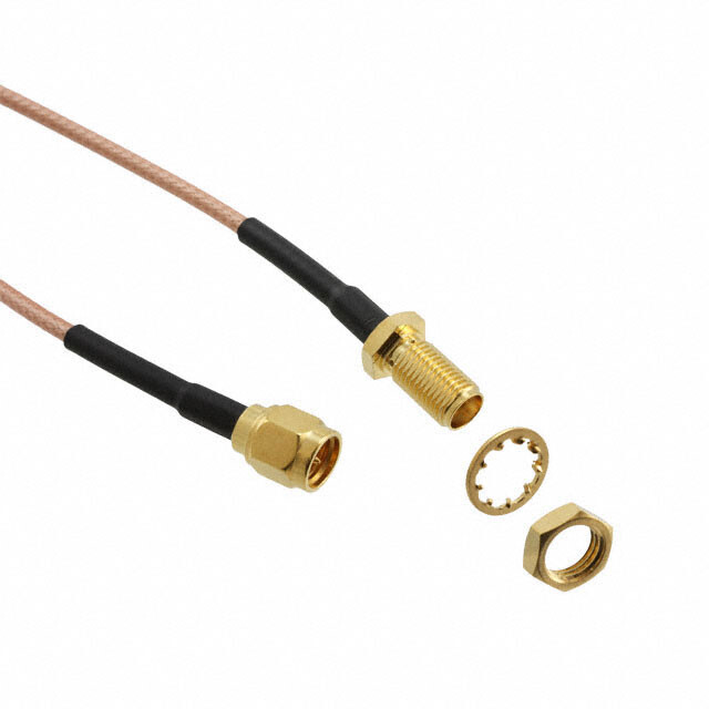

I am looking for coaxial SMA female to SMA male cable for 8GHz to 12GHz or 1GHz to 18GHz range with a minimum length of 1m. Could you please provide the suitable part number and details?
Kindly see Part Number 415-0031-M1.0 from Cinch Connectivity Solutions Johnson
There’s some question as to what is meant by “low loss.”
At GHz+ frequencies and meter+ lengths, cable losses become significant if a person isn’t using a coax material that’s of similar or larger diameter to an SMA connector. ARF2840-ND may be another item to consider.
Thank you for the response. However, I need a 2m length. I went through your suggested part number. The length is 1m.
Hello priyanka.hemani,
I see your original request was for a minimum length of 1 meter. I searched for a 2 meter cable, and the only option I found was 732-655035032200003-ND, which is only rated for 1GHz.
I also looking for a longer cable for the higher frequency, and the only one longer, than the one Kristof_2649 offered, is part number J10116-ND, which is 4 feet (1.2 meters) long.
If you need a 2 meter length, you can always combine two of the 1 meter cables together.
