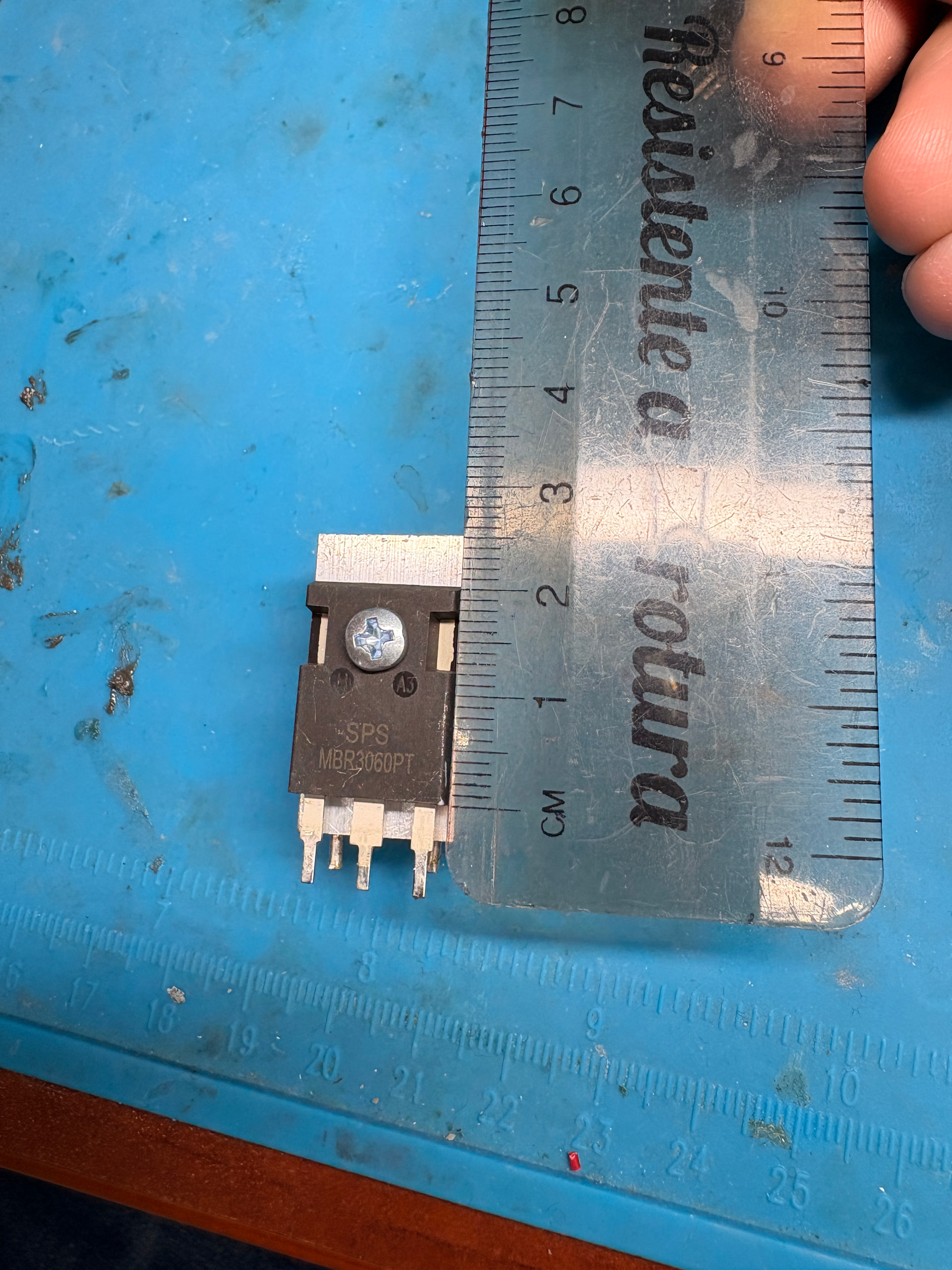

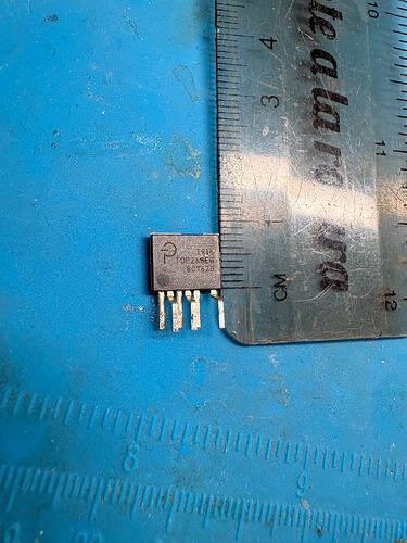

Please help identify these parts.
Hello panegyric13,
I did some looking on this, but I cannot say for sure these are right, but it looks to me like these would work for replacements. The top picture looks to be similar to 497-14232-5-ND and the second one looks to be 596-1206-5-ND.
I propose my own answer:
1916
TOP268EG
8C762B
https://www.digikey.com/en/products/detail/power-integrations/TOP268EG/2256092?s=N4IgTCBcDaICoHkAKYBsAOAogcRAXQF8g
SPS MBR3060PT
https://www.digikey.com/en/products/category/diodes/rectifiers/2085?s=N4IgTCBcDaILICEBKBmADANjQBQCogF0BfIA
