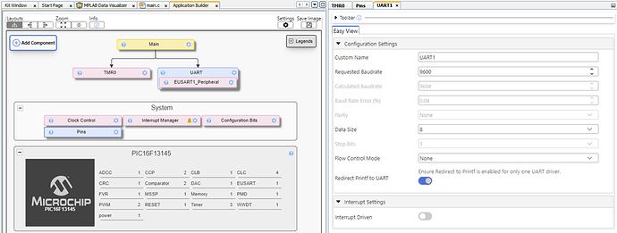

How to Configure the UART
Figure 2 presents the graphical configuration:
The UART has been added to the application builder.
The baud rate is set for 9600.
The printf() stream is redirected to the UART (blue slider).
Once the MCC .h and .c files are generated, we are ready to print to the serial port using code like this:
printf("Hello World!");
Figure 2: Configuration of the UART baud rate as well as redirect of printf to the UART.
