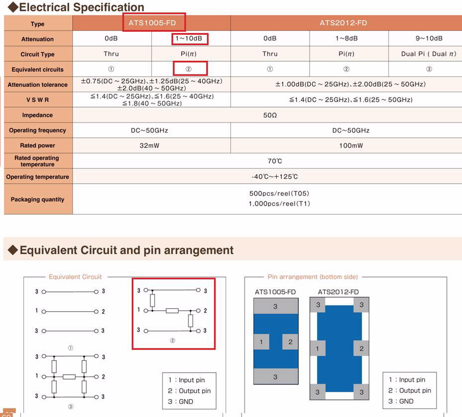

We have received calls lately from customers wondering where the marking is for pin 1 on the ATS-FD series of attenuators from Susumu such as the ATS1005-6DB-FD-T05, for proper orientation when adding this part to the PCB. We reached out to Susumu on this one and received the following answer:
Regarding our ATS****-FD series, there is no orientation.
The internal resistive patterns are point-symmetry as below.
