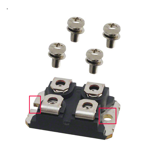

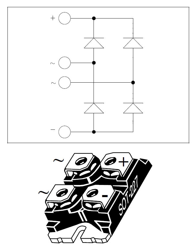

Pinout on Microsemi Chassis Mount Bridge Rectifiers
When you are looking at chassis mount bridge rectifiers from Microsemi Corporation you need to pay attention in the Datasheet to the notch vs the hole used for mounting. In the diagram it will call out the input and output sides of the rectifier, however the only indication in the drawing will be the notch vs the hole. See the picture below for an example.
