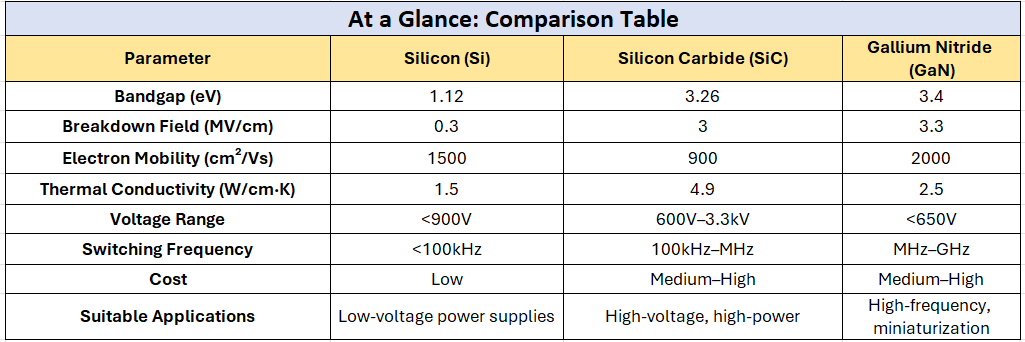

Key Parameter Comparison: Silicon vs. SiC vs. GaN
