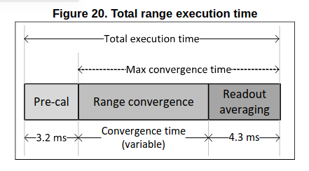

Also, can you explain why you are only waiting 100us before attempting to read the range measurement? I may be missing something, but Section 2.7.1 of the VL6180 datasheet suggests it should take on the order of milliseconds for a single range measurement to complete, especially with averaging. I would suggest polling bit 2 of the VL6180X_REG_RESULT_INTERRUPT_STATUS_GPIO register as done in the Adafruit library instead of a simple delay.

I missed that spec in the data sheet about 3.2 ms between reads. The device I was working with suggested much less. I’ll update my code and try it.

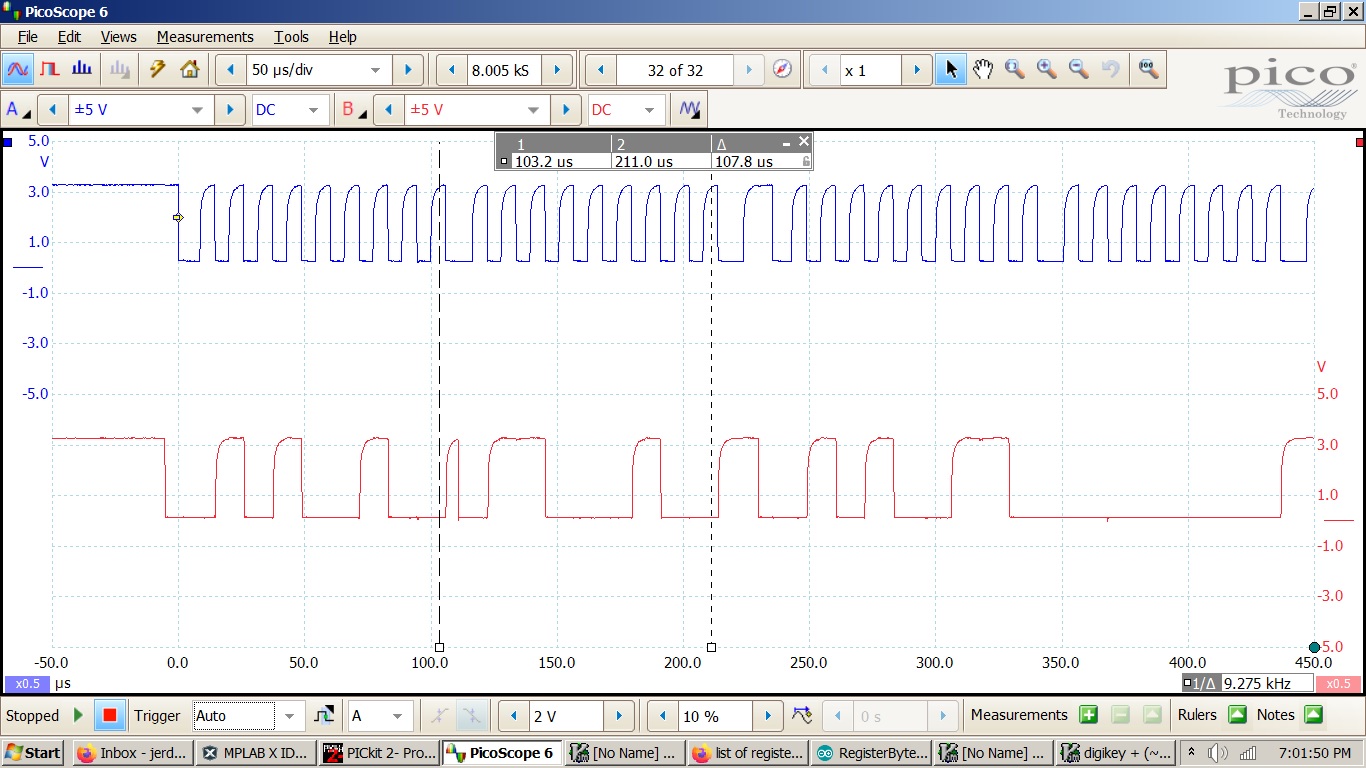

Matt_Mielke,
Finally updated my code to wait 4ms between readings and got some scope shots.
START.jpg are the waveforms for the first three steps that initiate a measurement.
READ.jpg are the waveforms for the last four steps that read the distance.
I placed the time measurement lines on the 9th clock to show the acknowledgements. According to the data sheet this should be enough to get a reading but as you can see I just get zero.

Hello @jerdonaldson,

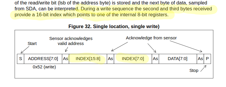

Thanks for the response and the screenshots. Looking again at the datasheet, I see that I missed something in my previous post. From Section 4:
Your code is using 8-bit indexing rather than 16-bit as specified. This can easily be corrected by padding the register addresses as shown.
I2C_Master_Start();
I2C_Master_Write(0x29 << 1); // TOF050C I²C address write
I2C_Master_Write(0x00); // DON'T FORGET ME!
I2C_Master_Write(0x18); // VL6180X_REG_SYSRANGE_START
I2C_Master_Write(0x01); // start a distance measurement
I2C_Master_Stop();
I assume this is why you were able to read the slave address at register 0x0212. You had to use 16-bit indexing to communicate this higher address to the sensor.
I’d also like to point out that 4ms is likely not going to be a long enough delay to allow the ranging to complete. The datasheet shows that the pre-calibration time plus the readout averaging period alone will take 7.5ms (assuming you haven’t changed the default averaging period). On top of this, you have to allow for the range convergence time, which Table 11 indicates may take anywhere from 180us up to nearly 11ms! Figure 20 summarizes this nicely.

Matt_Mielke,
Good stuff.
I have worked with some sensors that had 8 bit register addressing. I’ve just got to read the data sheet more closely.
I added the extra byte for the register addresses and increased the wait time to 20ms. Now I get reasonable distance readings.
