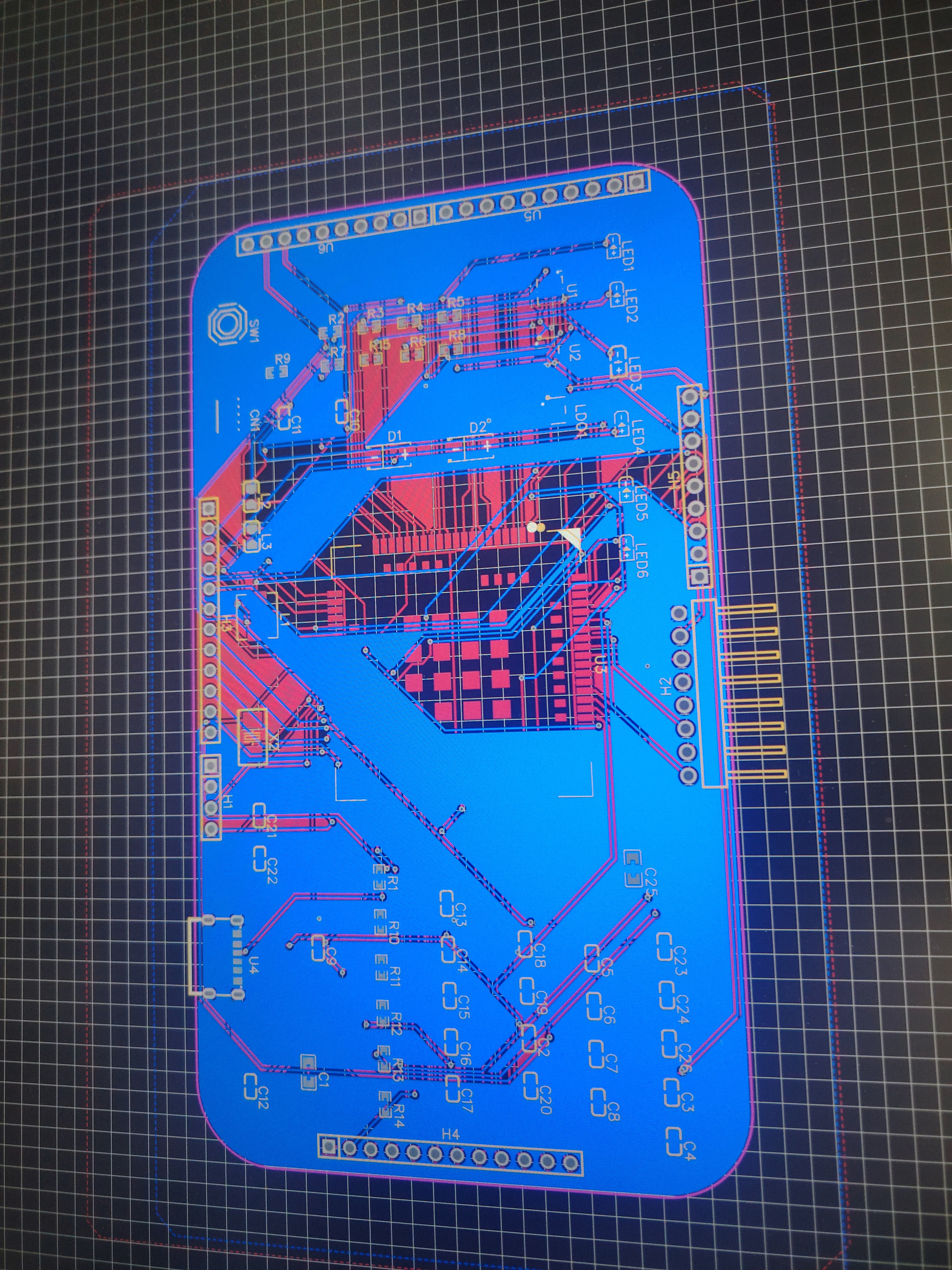

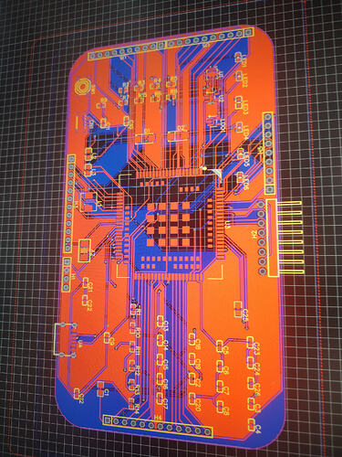

Hello everyone,
I’m excited to share my latest work: Project Al-Waraqah, a fully custom development board powered by the new Raspberry Pi RP2350 (QFN-80).
This board is part of my ongoing journey in learning PCB design, improving my hardware skills, and building creative, personalized tools for embedded development.

:wrench: Main Features
Microcontroller: Raspberry Pi RP2350, QFN-80 package
Crystal Oscillator: 12 MHz SMD (5032 package)
Integrated Li-Po Charging Circuit: MCP73831
USB Type-C Connector (with 5.1 kΩ pull-downs for CC1/CC2)
2.2 µH Inductor (LQM21 Series) for the internal regulator
Standard GPIO Headers:
12-pin headers ×2
14-pin header ×1
SWD programming header (1×4, 2.54 mm)
Clean power distribution with VSYS, 3V3, and USB_5V rails color-coded and routed carefully
3D model and footprint fully designed manually to match the RP2350 pinout
:hammer_and_wrench: Design Tools
Schematic + PCB: EasyEDA
3D Mechanical Model: Custom STL
Full custom footprint + pad size correction done manually
This project helped me deeply understand:
How to route around a 80-pin MCU
How to integrate Li-Po charging into the PCB itself
How to design stable power rails
How to manage USB-C correctly
And how to organize GPIO groups for easier prototyping

:rocket: Next Steps
Completing final routing
Generating Gerber + Pick & Place
Sending the board for PCBA with RP2350 pre-soldered
Building the first working prototype

If anyone is interested in RP2350 projects or has suggestions for improving the design, I’d love to hear your feedback!
