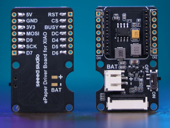

ePaper Driver Board
The ePaper driver board is a 24-pin FPC connector with a JST 2-pin BAT connector for easy battery connection and a built-in charging IC for safe battery charging. It is best for creating Wi-Fi-based digital photo frames.

Step 2. Insert the XIAO into the ePaper Driver Board
Align the pins and insert the XIAO ESP32C3 into the XIAO socket of the ePaper driver board.
Step 3. Insert the ePaper Display into the FPC Connector
Insert your ePaper display into the board’s 24-pin FPC connector.

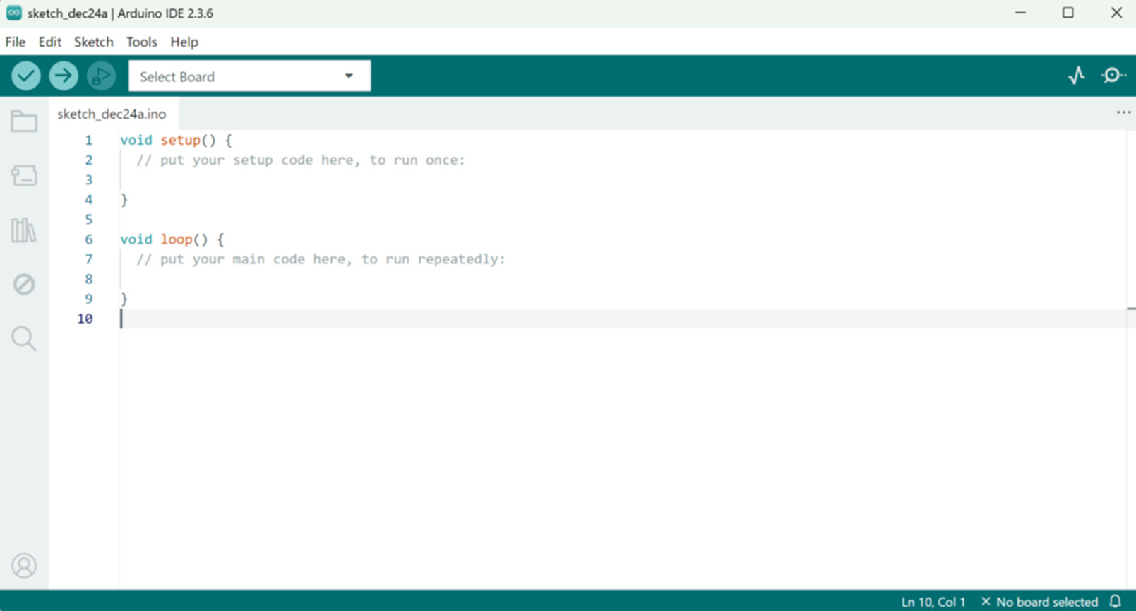

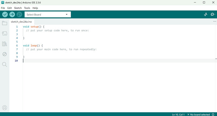

Step 1. Access the Arduino App
Download and launch the Arduino app (https://www.arduino.cc/en/software/).

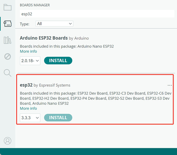

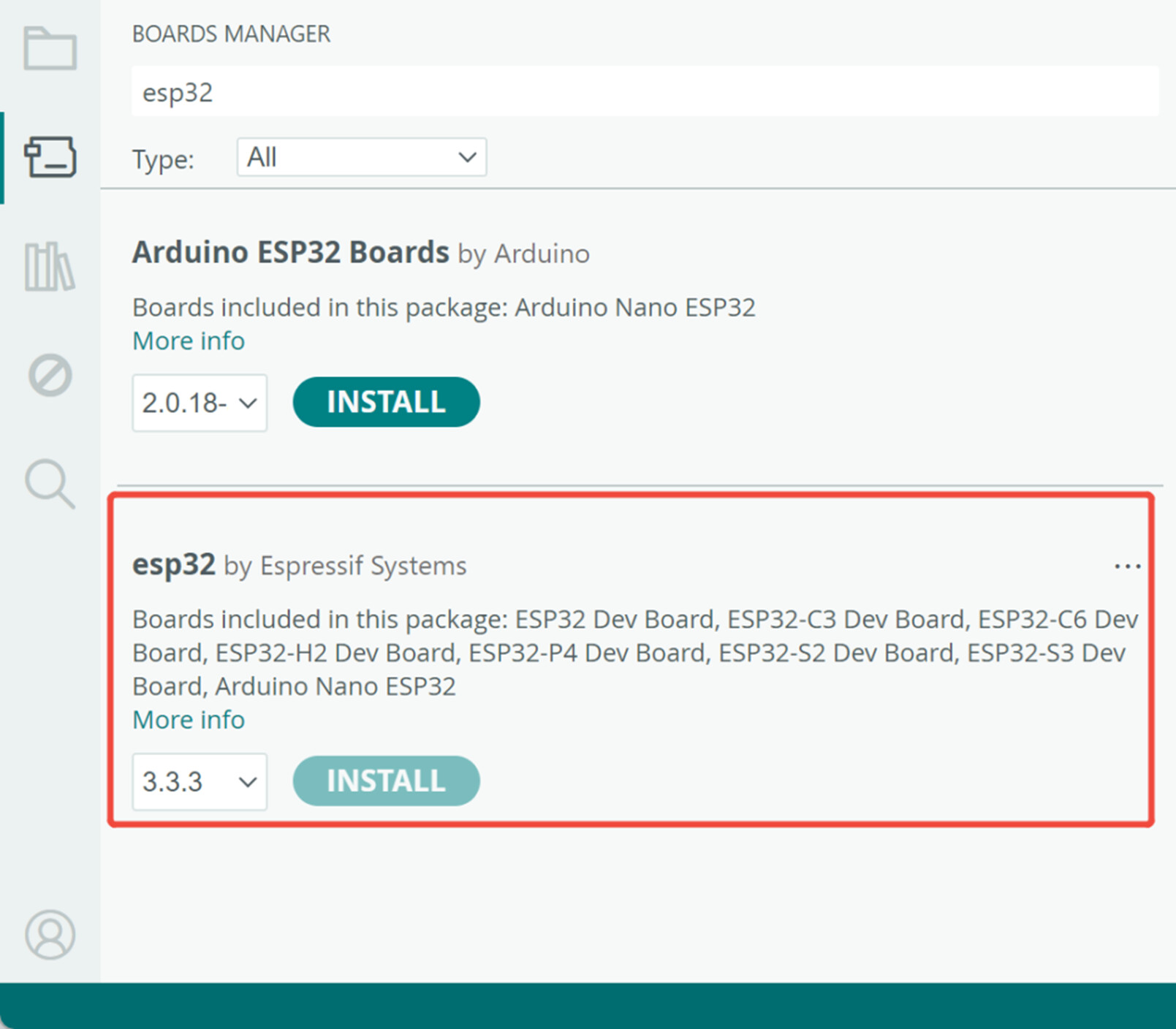

Step 2. Add the ESP32 Board
Add the ESP32 board package to your Arduino IDE.
To do so, go to File > Preferences, and fill “Additional Boards Manager URLs” with the URL below:
https://espressif.github.io/arduino-esp32/package_esp32_index.json
Next, go to Tools > Board > Boards Manager. Type the keyword “esp32” in the search box and install the latest version of esp32.
