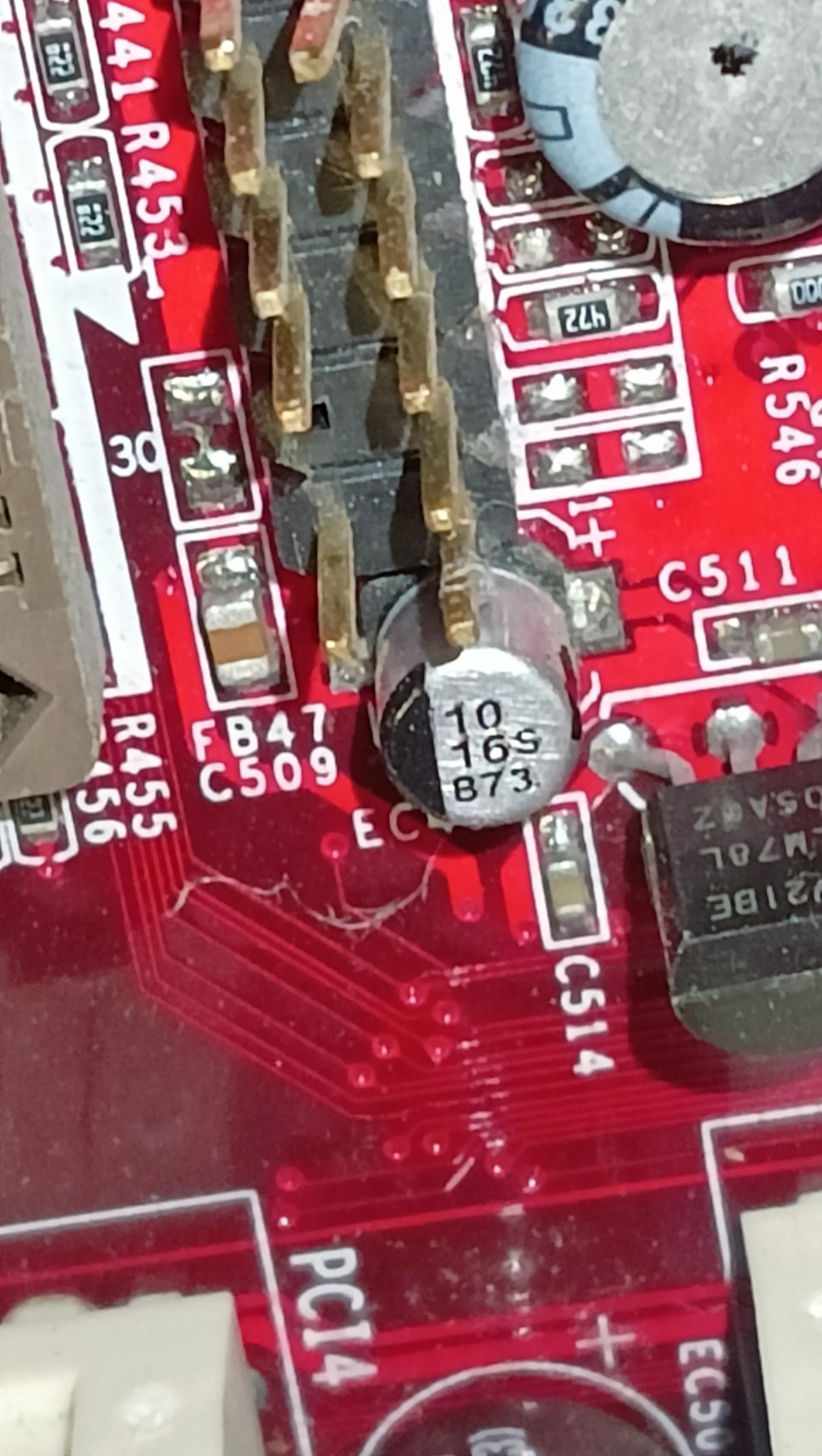

Checking if anyone would be able to check my thoughts on these caps found in an LCD monitor video board.
I’ve located replacements from Nichicon UCQ series which an audio series and I’d like feedback if there would be a better option given the application. I believe one of the originals is a Nichicon M3 series but I can’t find specs on that series.
Most confusing to me are the values like 10A and 16S which I’m expect may be a voltage with size, but that’s a guess. The diameters are of the originals, the replacements listed are of the same size (at least the datasheet says they are).
Thanks!
Hello @jeffd
Welcome to the TechForum,
looking at the list of parts you have, they are all good replacement parts for the original parts. The A and S in the 10A and 16S would be series indicators.

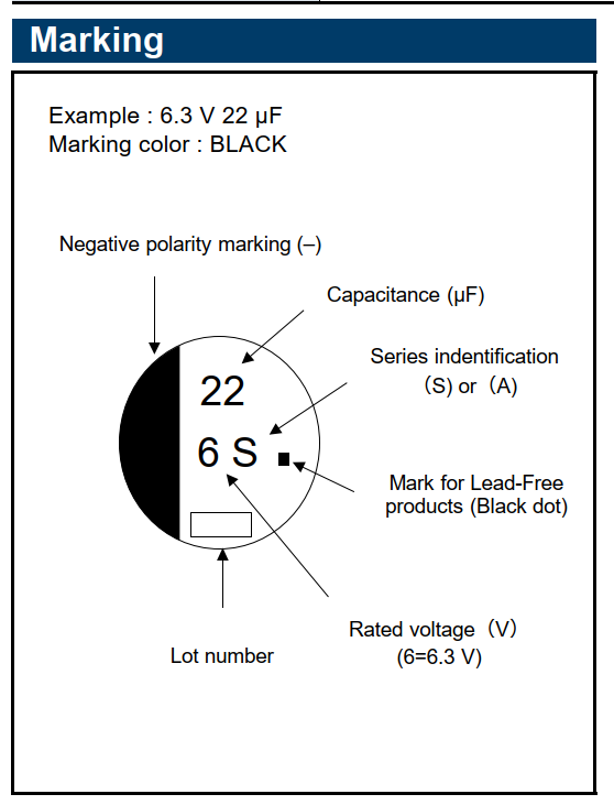

Thank you for your post.
Using this datasheet from Nichicon as an example, the capacitance and voltage markings would be correct.
