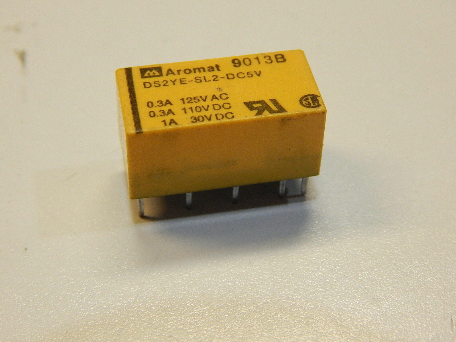

Suitable Replacement for Aromat DS2YE-SL2-DC5V
Hi everyone. I have an Aromat DS2YE-SL2-DC5V that I bought twice on eBay. Somehow after I tested one to see if they work after I installed it, it ends it not working after testing it for the first time to make sure it works correctly. Is there a suitable replacement for this type of relay pictured below? Thanks.
I believe G6AK-234P-ST-US DC5 may work as a replacement. Please read over the datasheet.
Thanks. I’ll take a look of it and will be open to hear from others of suitable replacements.
I bought those last night. Is there a recommendation on which temperature (Fahrenheit and Celsius) they should be hand-soldered at so they don’t get damaged and work properly? Thanks.
There is some general info for manual soldering relays on the Omron’s site here https://components.omron.com/us-en/faq/relays/FAQE10059.
  • Soldering iron: 30 to 60 W
  • Iron tip temperature: 350°C
  • Soldering time: Within about 3 seconds
