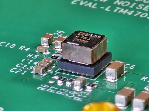

While smaller parts are challenging to cool, they provide unique opportunities. An example is the Analog Devices LTM4703EY#PBF, as shown in Figure 1.
This is a buck regulator used to power a low-voltage FPGA or uC core with a nominal 1 VDC at up to 12 A.
Other voltages are possible (e.g. 5 VDC at 12 A) as the output voltage is set by an external resistor. Negative voltages are even possible.
Why is the stacked inductor important?
If you look closely at Figure 1, this 49-pin BGA device has an integral top-mounted inductor. This inductor performs double duty as heatsink and primary inductance for the buck regulator. Note:

Figure 1: Close-up image showing the LTM4703. Seven BGA pins are visible as well as the integral inductor.
Tech Tip: Figure 1 shows the LTM4703 regulator as installed on the EVAL-LTM4703-AZ evaluation board.
The evaluation board is a learning platform allowing us to study a working design. We can see circuit topology, operating curves, waveforms, the PCB layout, and even the BOM to better understand why certain components were selected.
