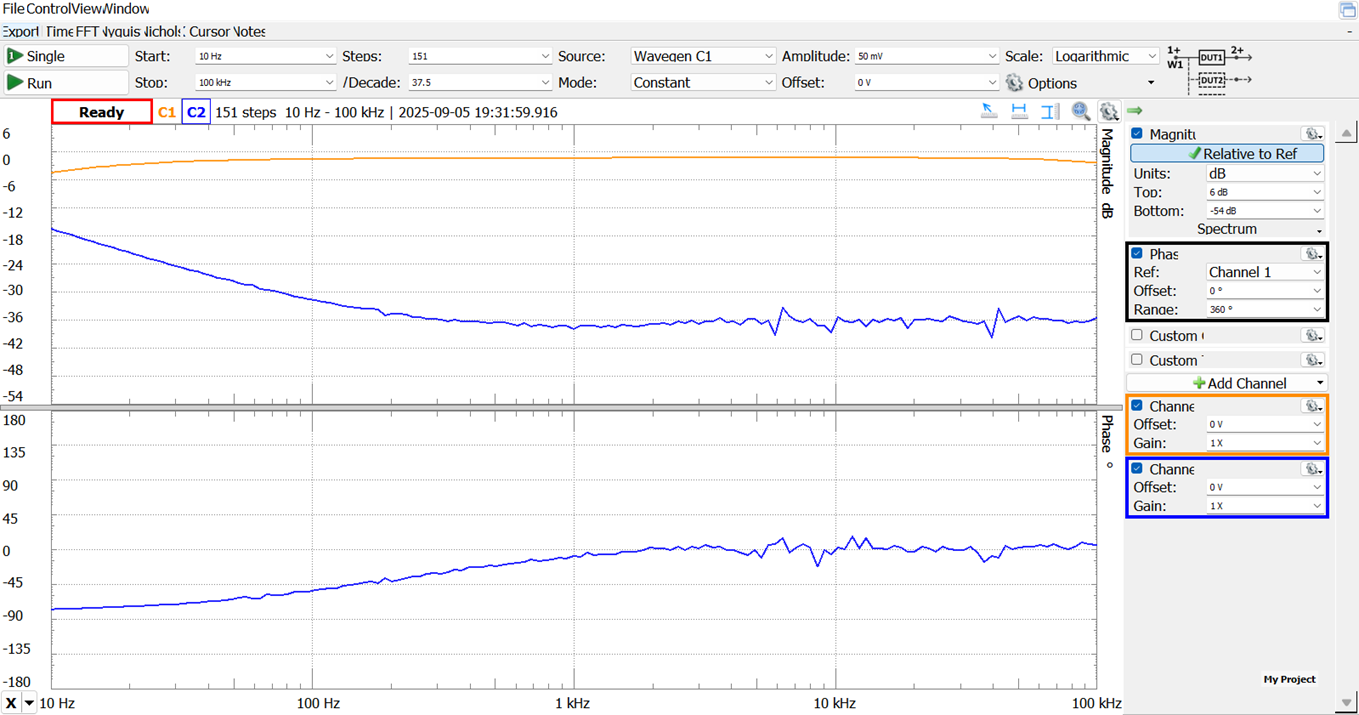

Part 2: Frequency Sweep at Low Amplitude
The second experiment is to frequency sweep the transformer using the advanced features of the Digilent Analog Discovery. The results are shown in Figure 4. The transformer input amplitude is set to 50 mV.
The voltage (orange) is relatively flat dropping approximately 3 dB at 30 Hz.
The current (blue) increases significantly (18 dB) for the lowest frequencies.
Observations
This experiment demonstrates that the transformer’s frequency response is generally acceptable for small signals. It isn’t high fidelity (flat from 20 Hz to 20 kHz). However, it is certainly flat down to the lowest voice frequencies (300 Hz).
Figure 4: Signal sweep for the transformer at low signal level.

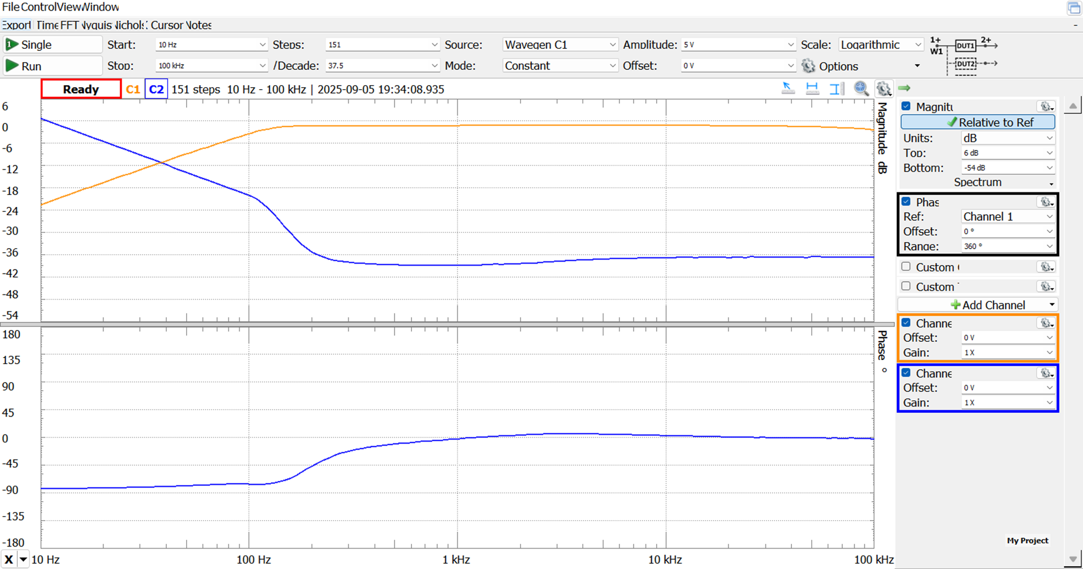

Part 3: Frequency Sweep at High Amplitude
This is the most important experiment in the series. Instead of feeding the transformer with a 50 mV signal we increase the amplitude to 5 V.
The resulting frequency sweep shown in Figure 5 stands in stark contrast with Figure 4.
The additional voltage causes the input current to increase by an astonishing 40 dB over midband current
The output voltage drops like a rock for frequencies less 200 Hz.
Despite this apparent deficiency, the transformer still operated perfectly within the datasheet specified low frequency limit of 300 Hz.
Observations
High voltages at low frequencies are associated with high currents in a transformer.
Figure 5: Signal sweep for the transformer operating at a high signal level.
