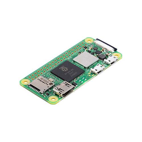

It’s hard to beat the price of this, but it’s way overkill for your needs..
