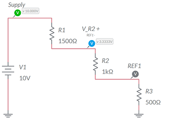

Solution for a Three-Resistor Network
The generalized equation used to determine the voltage drop across any individual series-connected resistor is:
V_{R_X} = V_{In} \left( \frac{R_X}{R_{total}} \right)
The relationship is shown in Figure 2. This example shows the voltage as measured across R2. We recognize that the multimeter’s black reference probe (REF1) is connected to the junction of R2 and R3. The multimeter’s red test probe is connected to the junction of R1 and R2.
Figure 2: A voltage divider featuring three resistors
