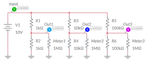

5) Locate the specifications for the voltmeter used in your lab. What is the input impedance? :graduation_cap:
  • Answers will vary.
  • You are encouraged to verify your work using DigiKey’s voltage divider calculator.
  • Finally, you are encouraged to build a circuit to demonstrate circuit loading. I have used this simple circuit (below) with excellent results in the lab. This is also an excellent launching point into Thévenin equivalent circuits.
