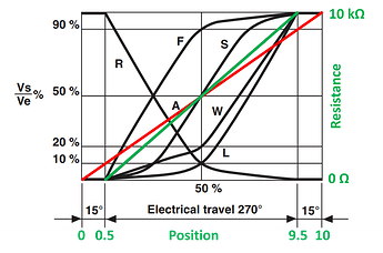

Figure 2 presents the output voltage (percentage) as a function of the variable resistor’s shaft rotation.
- The ideal linear resistor is shown as the red line.
- The green line presents the response of a Vishay P11S series potentiometer.
There is a significant difference between the ideal and the real-world performance especially when we consider the end travel, where we see a 15-degree deadband. This observed non-linear relationship for a “linear” (linear-taper) variable resistor is a stumbling point for the uninitiated.
