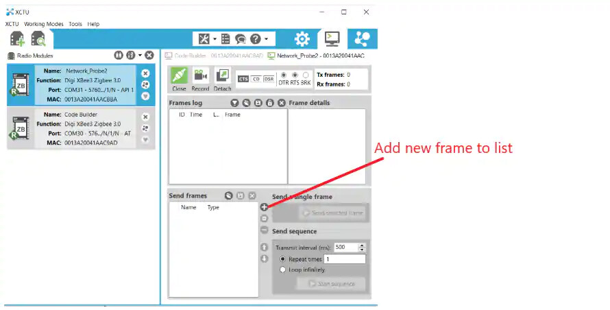

Step 3: Add New Frame to List and Open API Frame Generator
Select “+” to Add new frame to list
